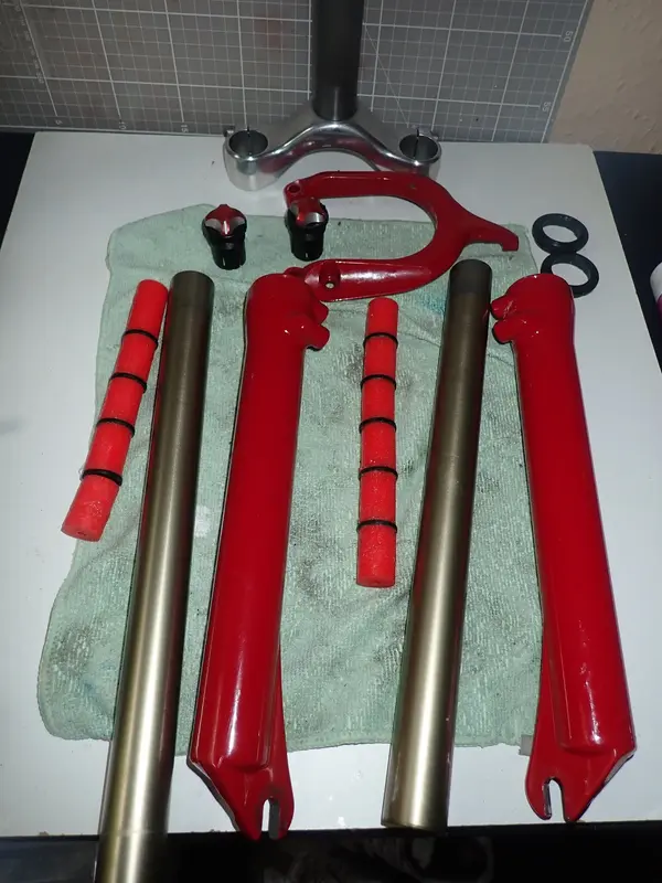

Finished the basic teardown, so far no problems except one of the bridge bolts has rounded, I'll almost certainly get a ti bolt upgrade kit for these anyway, so no drama.
The elastomers are in very good condition, although one set is slightly shorter than the other, stansions look to be in good order too.
Time for a fry up before I remove the dampers.
It looks pretty shorter! ...It can cause problems with the rebound after load. I personally wouldnt leave it like that and give it a fresh elastomer set.
I agree, and although I respect your entrepreneurial spirit I'm going for springs this time.

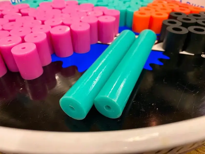

It doesnt matter - since I also offer the full spring kits in my portfolio .-) Has nothing to do with any kind of "entrepreneurial spirit". Rofl ...
I am always curious why people choose springs over elastomers. When the performance and the ride feel of steel springs are way "worse" then elastomers? Also the costs are almost the same. The work and effort you have to do for servicing is also the same. AND with this fork model, a service and maintainance (lube) dont even take 5 minutes. In contrary to other forks where servicing or reaching the elastomers or springs can be painful.
There are VERY few serious reasons to really choose springs over elastomers in the end ... #justsaying
