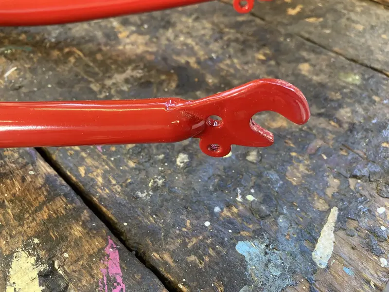

Hi
I’ve just picked this frame up . Wondering if anyone could help with identifying what model M2 , what year it could be ?
Serial number is 1990 . Does that make it a 1991 or could it be later?
My thoughts are it’s been repainted, repair to the dropout is later . Fork possibly not original?
Any thoughts on this gratefully received.

Hi
Thanks
It’s a 1991 M2. It’s been repainted, the fork isn’t original and someone has replaced the downtube cable stop plate.
Dropout repair is interesting. These didn’t have removable hangers, so it doesn’t seem unlikely that it would break off or strip despite the dropouts being a good 6mm thick.

Thanks for your reply and info .
Yes the dropout repair is odd , I assumed it had broken off but perhaps the thread got stripped ?
I’ve tried to find evidence of original paint but it seems it was well prepped before it’s re spray .
Do you know what colour it would have been originally? Looking at the old catalogues it looks like it could only have been purple ?
I think I’ll keep it red and just apply new decals .
Thank again
The 1991 could have been Team Red (for the 500 Team Red models in the ad), champagne (for the 1991 Team) and magenta (for the base model 1991). Magenta ones are the most common. If going red I’d say try to find the correct decals, there should be a couple 1991 bikes in this thread for reference. They changed them up slightly pretty much every year.
