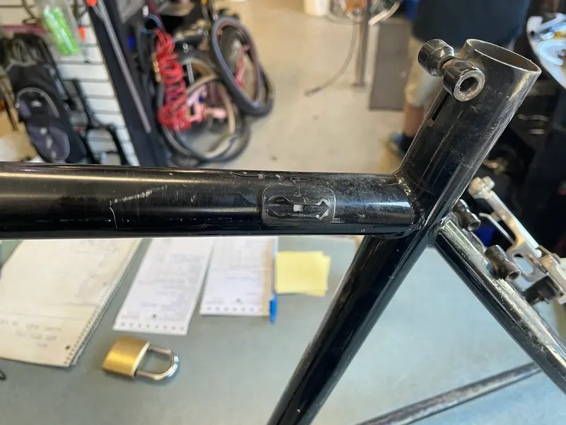

Someone has added a cable guide to the top tube for V-Brakes. It looks professionally done.

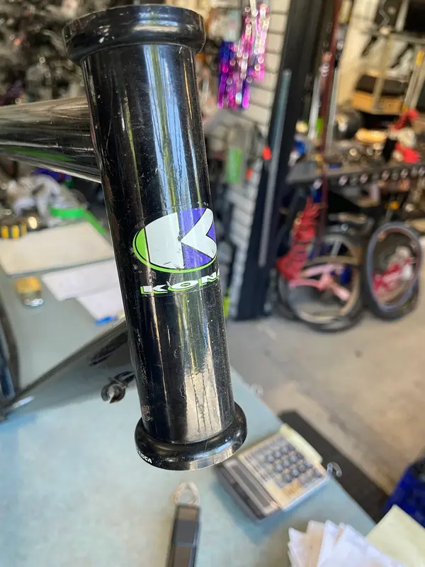

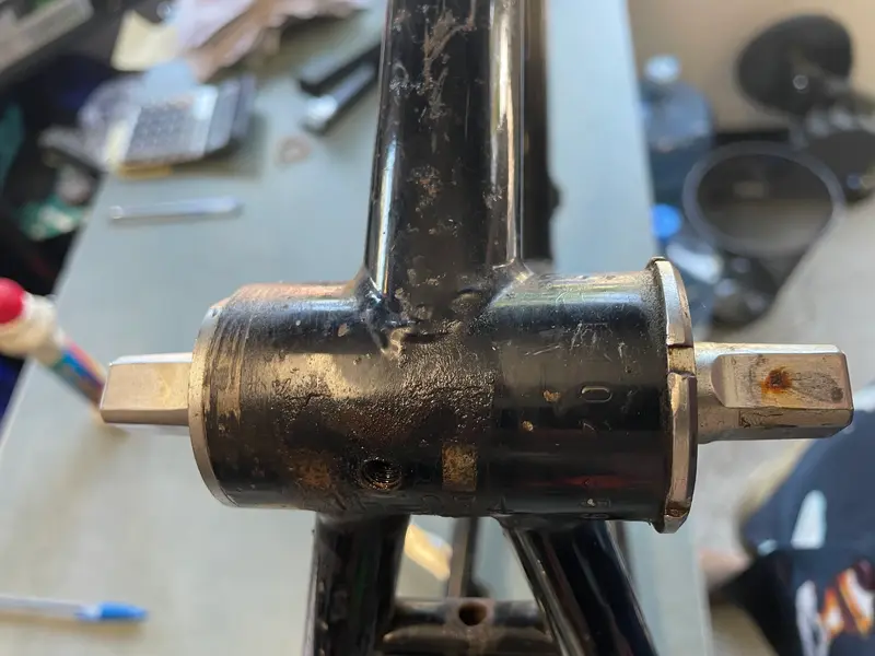

There is nothing to suggest it isn't a '91 Explosif, serial number would match as would the tubing. It "could" be a '92 Explosif Pro, which in reality were just the leftover frames from the previous year with a custom paint option. The black Pro's tend to have a slight metal flake which it doesn't look like this one has, but hard to tell from the photos.

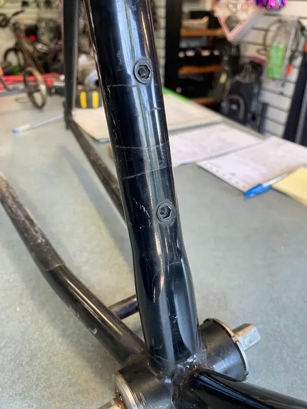

Isn't that added cable guide just a stick on plastic one (assuming you mean the one in the 4th pic)?

Very possibly may just be a stuck on item. I didn't want to try prying off as it is not mine yet.
Having seen the '92 Pros I am gonna say no it is not. Basic deep black paint.

'91 Explosif, the '92's have a seat clamp, though some unused '91 frames were used in '92 hence the added rack mounts. Both same frame so not really an issue. Black was an option anyway in '92, the pro only had different spec components than the normal explosif.
