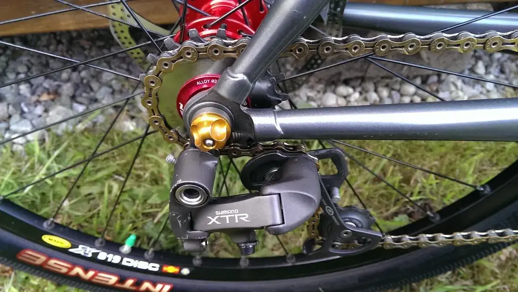

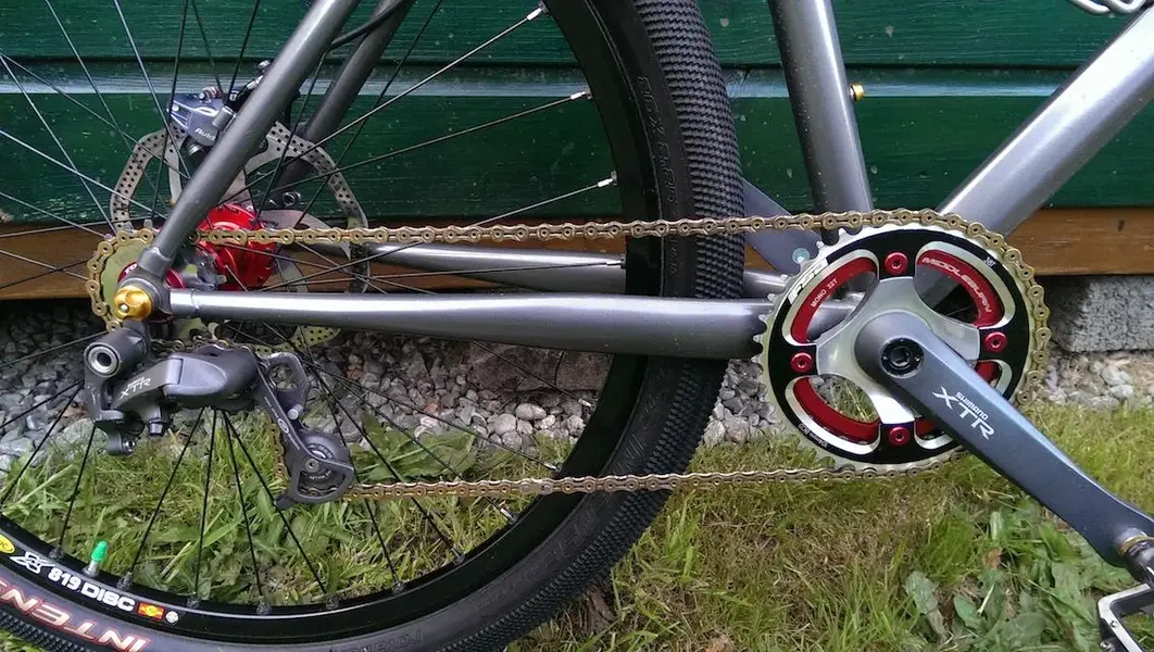

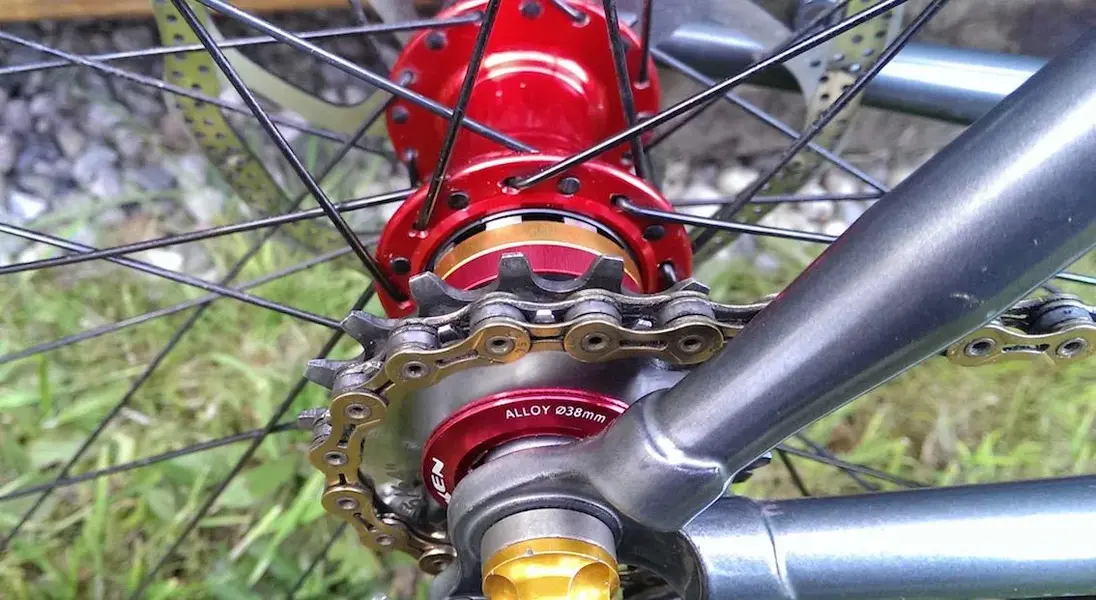

so, has anyone else done this...?!
i love my singlespeed, but find it such a compromise on an all-round bike
either too high-geared so no use off-road, or too low geared and legs spinning....
two single speed bikes is an extravagance, so i got my thinking cap on and came up with this!
it's probably nothing new, but i felt like i'd re-invented the wheel once i'd finished! :lol:
the rear mech works as a tensioner, and with a quick turn of a limit screw, i can switch between 38-16 for bombing around on, or 32-18 for some off-road fun! 8)
chain line isn't quite perfect, but the limit screw on the mech runs out of scope, would really need to push the BB out a few mm if i was being super-fussy, but it works a treat!

If you want to spend some time working out magic ratios and making a sliding tensioner you can use the same length chain on two singlespeed ratios. Similar to what you have now. But no messing with screws. Just derails from one ratio to the other by hand.
Something like a dinglespeed.
