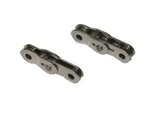

Right, Spring switched so that I can push up. Now my chain tension is too loose. Cannot remove a link as then too short, so looks like this is the alternative...remove full link & buy a half link to plug the gap or fit a larger rear sprocket or front chainring. (Would rather fit a rear sprocket)

Just get one of these, once you've ascertained that you'll be able to lose one pitch (1/2"). You'll need a couple of master links too.
Ghost ring is good but you need to have the chainline well inboard which is often impractical as regards ring choice.
Half links are a simple solution but they can stretch more easily than normal chain, you can get BMX style chains entirely composed of halflinks which makes chainlength tuning a doddle.
