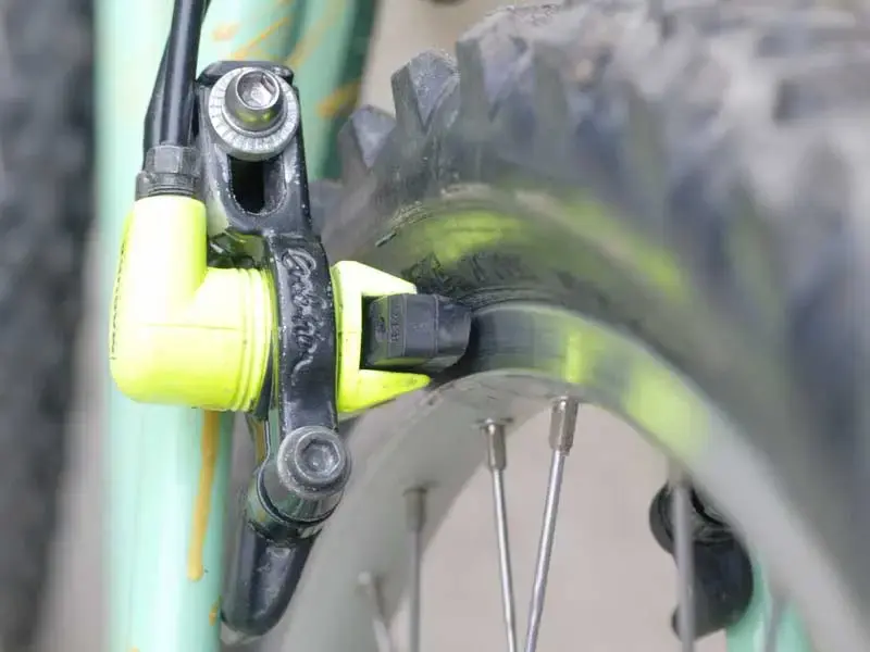

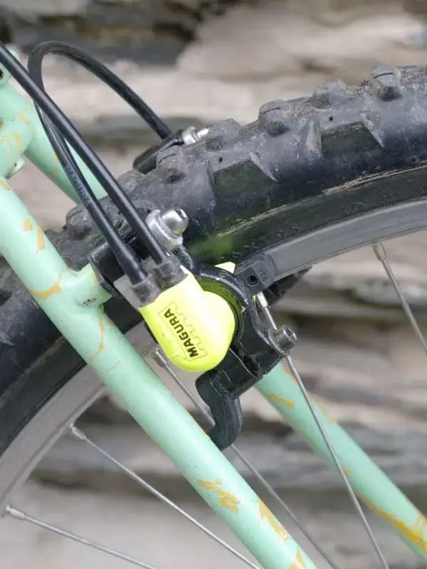

Here's where I am at the moment with the Magura HS33's on my singlespeed Explosif . Since I had them anyway (and they hadn't cost me a fortune either) I decided to try and squeeze a little more adjustment from the rear cylinder adaptors. I extended the slots both upwards and outwards by amout 2mm in each direction and also filed about 1mm more clearance on the outside face to allow the cylinder to tilt down a little.
It's tight, but it all works (as the actress.... :oops: ) . I wouldn't have modified the mounts like this if it had been a front brake as the consequences of something "letting go" would be much more serious :!:
Haing said that it all seems fine - I've ordered a new set of pads as I expect they will give me a little more to play with.
I've dispensed with the QR on the rear brake - an allen screw and a decent washer seems more secure and I can live with removing one screw to get the wheel out.
At some time in the future I might get myself a set of the cylinder clamps that fit the braze-on mounts (like are used on trials bikes) and make up a one piece "arch" type plate to fit over both U brake studs that these can in turn be fitted to.
