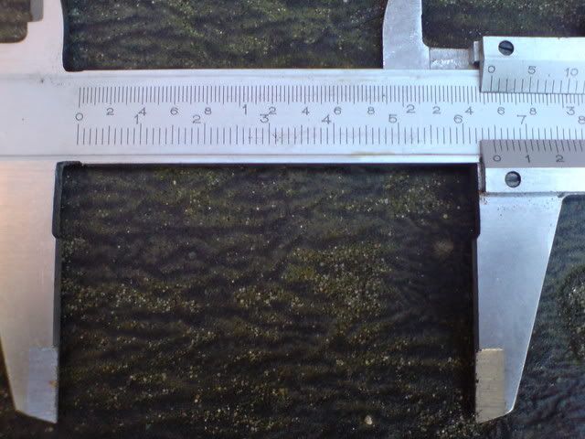

Right i'm awake now sort of so here goes
1st pic, Bit clearer picture of the canti as you can see it fits flush and follows the line of the seatstay.
2nd Pic, is with the canti bolt and wheel removed, not much to see but you can just see where the mount has been filed out. I measured the canti boss on the frame and it was 9mm and the magura canti mount is 8mm, So it is basicly a case of file a bit out, try it, file some out, try it, until you get a nice snug fit
3rd Pic, is the measurement between the outside diameters of the canti bosses which came to 94mm
4th Pic, brakes mounted with calipers upside down
5th Pic, Is the measurement between the top inside edges of the magura mounts, 65mm
Last pic, Is with the brakes mounted and wheel fitted, Now on mine its a very tight fit, because i use the widest tyre i could fit in the frame which was a 2.3 Kenda Kinetic. If you use a thinner tyre you would have more clearance
Its one of them jobs that's a bit of a bodge job until its all fitted up then it comes together at the end and looks fine and works a lot better than a U brake. Just to add no mods were done at all to the frame so if needed a U brake could be re-fitted at some point without any problems.
If i've missed anything or you need some more info just give me a shout.
Oh and i'm not a lover of cleaning bikes as you can see. :lol:
Very many thanks for sending the pics - I should have realised, of course ,that the mounts would need altering to fit on the 9mm dia. U brake studs (compared to V brake dia of 8mm).
The only thing that isn't clear (well to me that is !) is what prevents the two "calipers" (for want of a better word) from rotating away from the rim as the brake is applied? Normally the arch assembly would do this but obviously with the brackets fitted upside-down this can't be used.
Or is it obvious and I'm just being extra thick ?? :oops:
What i did was fit the calipers, Then the wheel, Get everything lined up and running, Then lastly the 2 bits ive arrowed push against the seatstay then tighten up as tight as i could. With them being sort of splined they tend to get a good grip and will hold tight so when the force of the brakes are applied they wont budge and the seatstays will stop the caliper from parting.
