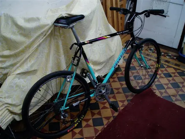

I’m thinking about converting my 21 speed Peugeot Black Mamba to single speed courtesy of a Woolly Hat Shop spacer set. The idea would be to run it high geared for commuting and then lower the ratio for when winter comes.
Does anybody run their day to day bike as a single speed? If so any pit falls I should look to encounter?
I’m after some inspiration. If you have any steeds in single speed guise could you post some photos?

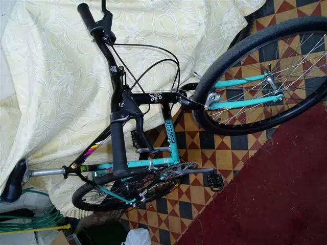

Below is roughly how my steed looks now (just without the riser bar)
Thanks for any help.
Mark

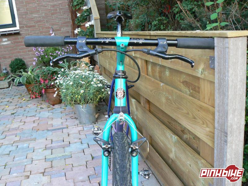

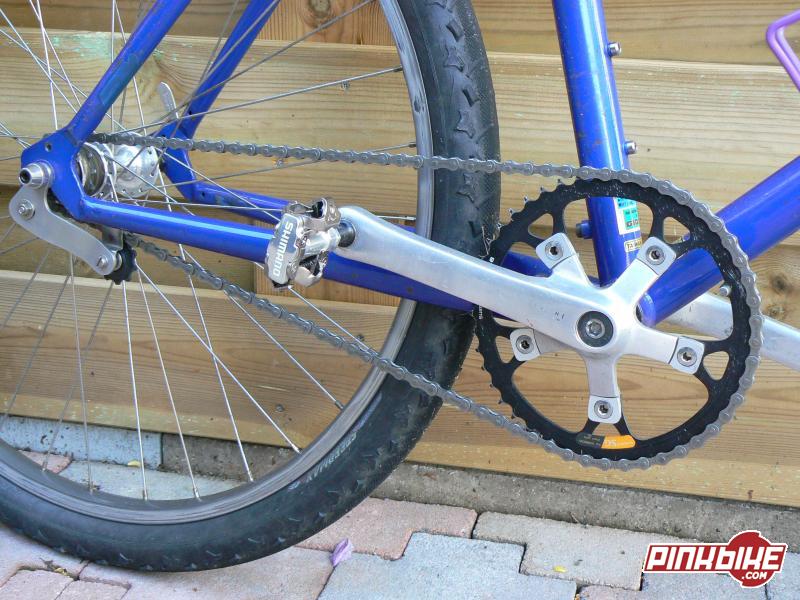

I've a singlespeed roadbike I commute on to work (53x18) and an offroader (32x16). I think the key is to get the chainline as straight as you can although as you have a bit more to play with than if fixed no real need to get it spot on (although of course no reason not to if that's what you like).
Also make sure if you are not using a tensioner (and much cleaner not to in my opinion although not an option unless you have at least semi horizontal dropouts and I can't see for sure if you have from the photo) then get the chain tension just right - not tight as a drum otherwise everything will wear out super fast - perhaps about 1 cm deflection when you press down on the chain from above.
Oh, and you may need to resit the chainring on the spider to make sure that it is as round as possible (also use a decent chainring) - see Sheldon Brown for details on this but it basically involves slackening off the chainbolts and then tightening alternate ones with perodic striking of the chain with a substantial implement, strangely satisfying.
That said you can ignore all of the above (as I initially did) and still get everything rideable - as usual if it looks right it probably is.
In summary, just go for it!

That Peugot looks great btw.
a beauty Peugeot, a good bike to make ss.

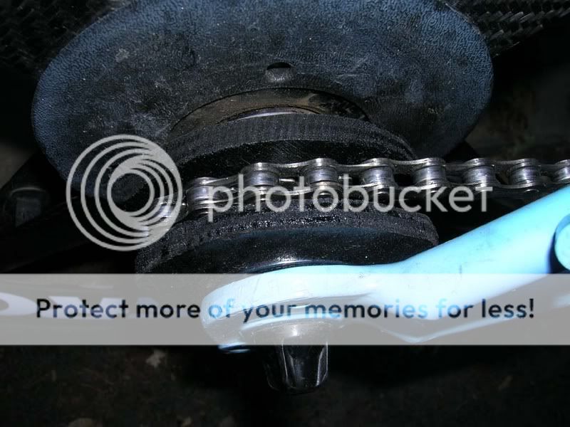

as you can see, I've gotten around the chain tensioner problem using a BMX half-link and some ghetto-rigged wooden plates I cut up. This worked for awhile, then things loosened up and and it all went to hell. I've re-tightened / arranged everything a bunch of times now, and in the end, I really dont trust it. If I was going to be doing some serious commuting, I'd put some sort of tensioner on there.
