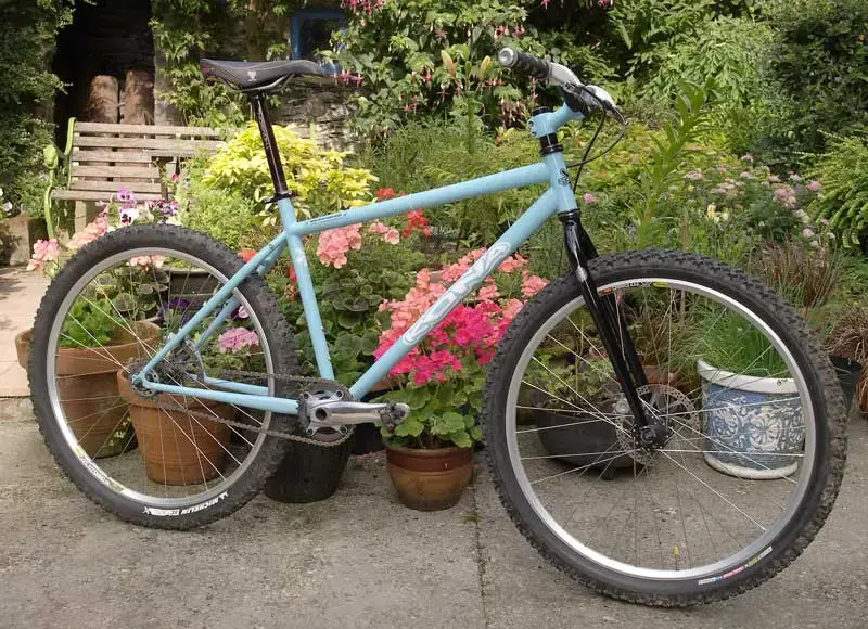

Anyway, for your edification, here it is in its latest iteration, now with Salsa Cromoto forks. (Any excuse, I know.....) It's a superb handling bike (everyone who's ridden it says so anyway...) that does everything with great poise and aplomb.
Nothing fancy, but it does it for me......
95 Columbus Max Explosif (with all cable stops, mech hanger etc removed and with caliper mount added and resprayed "Platsa Blue")
Salsa Cromoto forks 425mm A/C
Magura Marta SL brakes
Mavic 717/Shimano XT wheels
Thomson seatpost
No-name stem
Race Face Evolve Bars
Modified Shimano HT2 cranks
Trickstuff Excentriker BB.
DMR 32T chainring and Surly 18T sprocket.
KMC 610HX chain
Kona Jackshit grips
Ritchey WCS pedals.
That's about it ......

Andy R":z957h0xu said:
....my old heap of a singlespeed...
95 Columbus Max Explosif...
Andy, you do yourself down. It's a gorgeous machine and I'm green with envy. Real understated elegance. :wink:
Thanks for the comments guys, I really appreciate it 8)
As far as the Salsa forks go I can do nothing but recommend them. Previously I had a set of Genesis forks (OEM on the IO singlespeed) which look fairly Project 2-ish, but although they are supposed to be double butted they are a bloody harsh ride. The reason that I changed them though is that the dropout on the RH leg (which is part brazed, part welded to the leg) developed a crack in the brazing and, although I'm sure that I can re-braze it and it will be as good as it ever was, I took this as an excuse to get the Salsa's. Like I need an excuse...... :oops:
Salsa list these as being available in 425, 440 and 465mm A/C variants and in disc/canti and disc only versions. It seems that in Britain only the 425mm and 465mm (29er) versions are readily available and the 425mm only in disc plus canti.
So that's what I got, I removed the canti mounts completely (because they offended me as I'll never use them, ...) and resprayed the affected area which, as they're black, wasn't a problem.
I don't know whether to respray them the frame colour though ???
They seem a perfect match geometry-wise for the frame (which was after all intended to be used with 395mm P2's) and at the minute I just have an extra 10mm steerer spacer to take the bar height back to near enough where it was before. They are a lot more compliant and comfortable than the Genesis forks were and probably only something like the Vicious Cycles forks would be an improvement (but at a price.... :roll:).
Or carbon, but I can't bring myself to trust carbon forks.....
