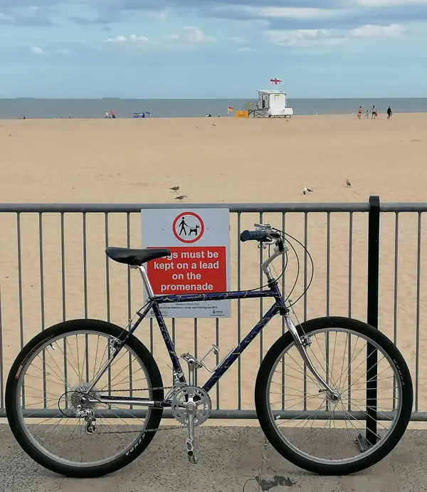

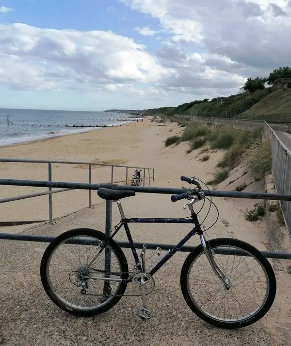

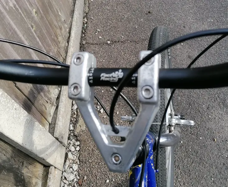

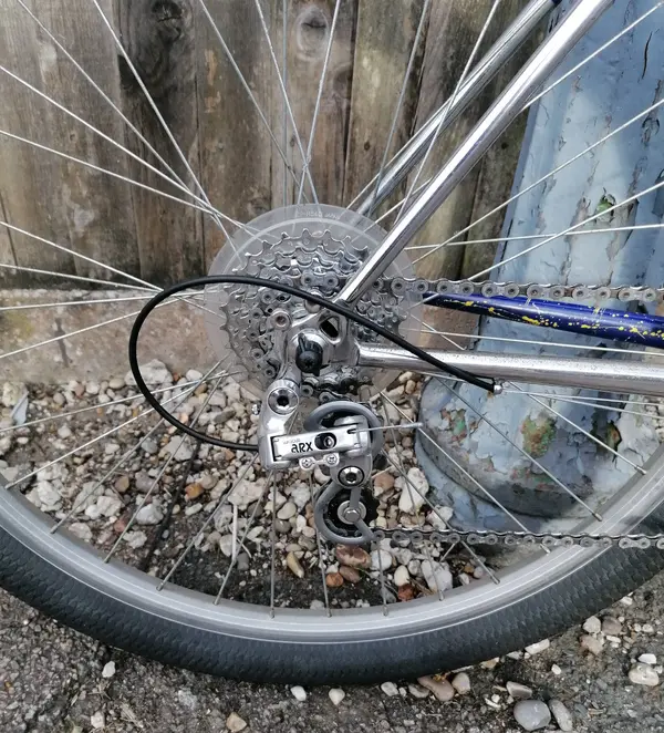

I bought this frame ages ago as an unknown frame and tried to build it up and got an Italian bottom bracket bound up not tight but stuck, so chucked it in the back of the shed and kept scowling at it from time to time. I had built up another fillet brazed frame which I soon came to the conclusion was too big for me, so I sold that and had all the parts hanging around. So about 2 months ago I dug this frame out and with some very ungentle persuassion I wrestled the bottom bracket out. I mostly built it up then started to build road bikes so this got put on the back burner. So Saturday I decided to roll up my sleeves and get it finished........... So as I said at the start I bought this as an unknown frame and I wanted to give it an identity, so like Baldrick I came up with a cunning plan find a list of Italian manufactuers and enter their name into Google followed by the words 'Mountain bike' after ruling out many, I typed in Simoncini Mountain bike and this popped up https://www.google.com/url?client=inter ... YMy2qBkSOg . I noticed a lot of similarities so decided this looks good enough, so a Simoncini it is.

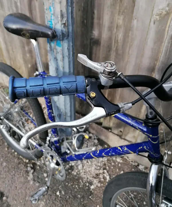

Handlebar: Factory Racing motocross black
Grips: Oury metallic blue
Barends: N/A
Brakes: Dia-compe
Brake Pads: CLB
Brake Cables: Various
Cantilever cable hangers: Dia-compe
Brake Levers: Dia-compe with gold bolts and Venhill adjusters
Shifters: Suntour ratchet
Front Derailleur: Suntour Mountech
Rear Derailleur: Suntour ARX short cage
Derailleur Cables: Various

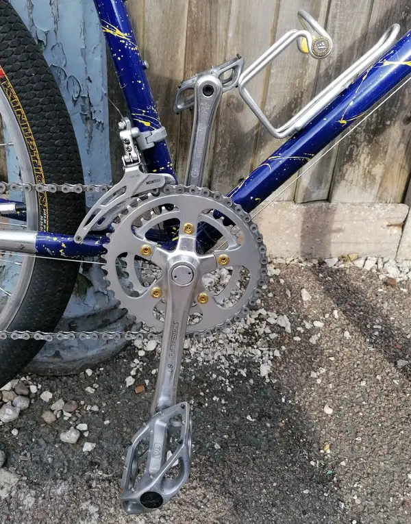

Cranks: Stronglight 80
Crank Bolts: X-lite caps
Chainrings: Stronglight 42/32
Chainring bolts: Gold Mowa
Bottom Bracket: Shimano XT

Some nice bits there :wink:
But the geometry is too retro for me. As a cruiser could work fine.

Cheers, it is a lovely upright laid back cruiser just as I had hoped but she feels like she would go with higher gearing. :D

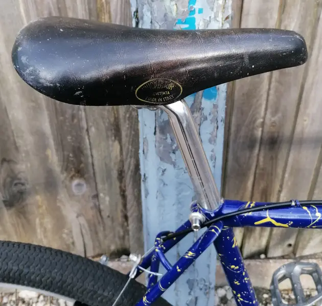

That is a lovely looking Simoncini , I like the Cinelli saddle and chrome forks a shame there are no rear rack braze ons that I can see .
