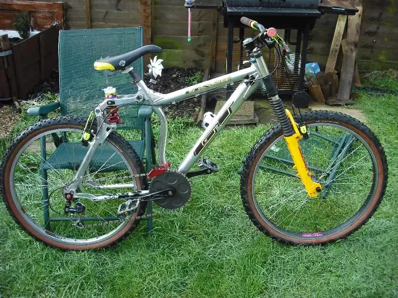

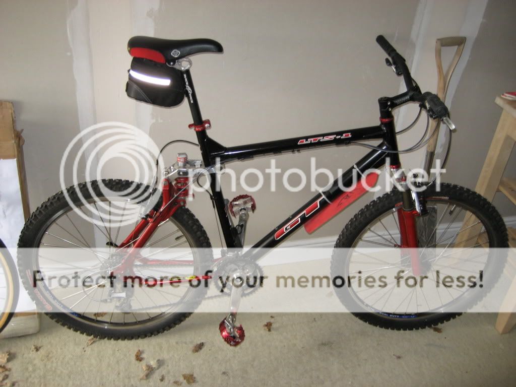

Ill take some of the LTS 1 too. Looking great with its colour coding... :lol:
LTS DH : (Pos... :? )
LTS 1 which is lovely!
The dh looks clean enough!! :D Are you building it for full on downhill style ?
The LTS looks lovely, thats where I want to be with mine. ..long way yet though
Its that a 18" frame? If so ....how tall are you?!!? :shock: :lol:
The black LTS1 is a 20" frame, Im 6'6", and 17st, hence the 800 Ib spring.

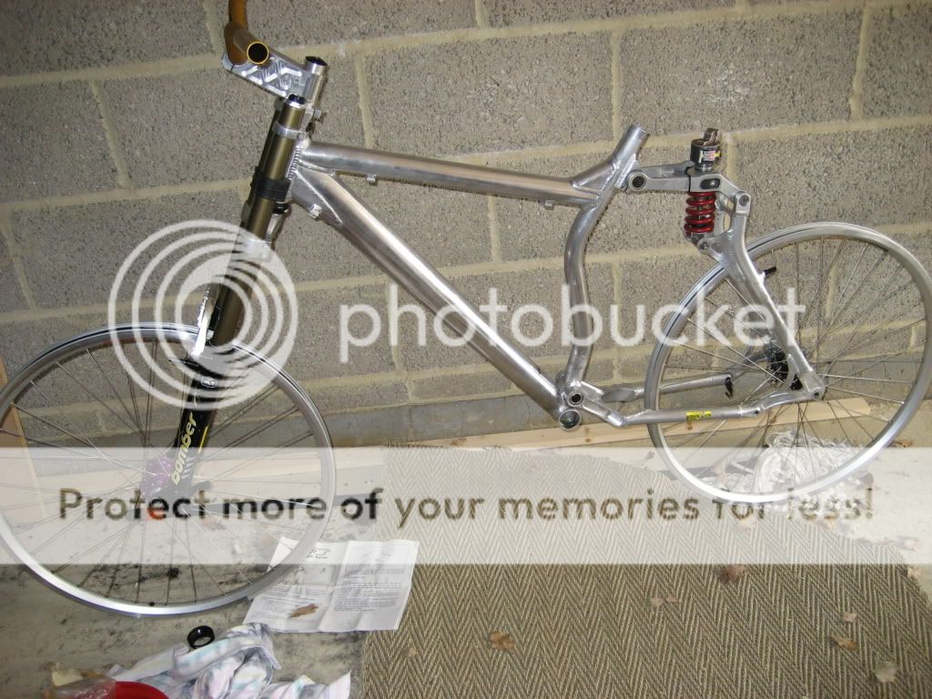

Actually feeling very pleased with myself - the LTS1 was creaking a bit from the trunnion, so I stripped it down and relubed with stendec fork grease, now silent. The build for the LTS DH is as follows:

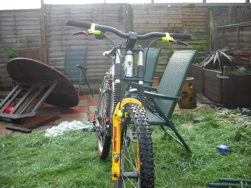

Front end : FSA PIG headset/Azonic stem/Protaper bars/Junior Ts
Brakes: XT Vs - 1st gen (levers and cantis)
R mech: 739 XT, to an 8 sp STXRC shifter pod
BB: Shimano most likely
Cranks: Sugino mighty 900 forged, with a 42t syncros ring (nice)
Wheels are d521s on an LX rear and hope front
Tyres - Nokian gazza's of the LTS 1
Seatpost - plain silver alu
Saddle - WTB same as on LTS 1
So I suppose Its a fairly DH setup.
Got a road cassette on there too.
Im gonna see how it feels static built, before I spend any money on shocks and bushings - I worry Its too small...
