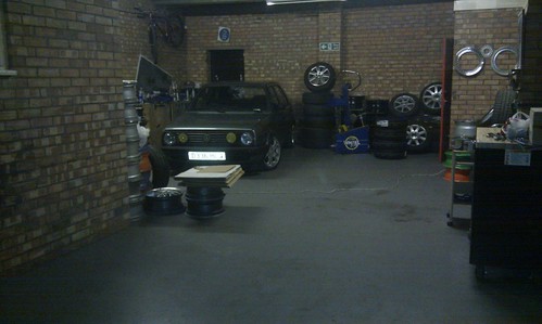

ill pop this in here. i really need to get shot as it as im maybe a little old for this now but every time i drive the damn thing its just too much fun :roll:
