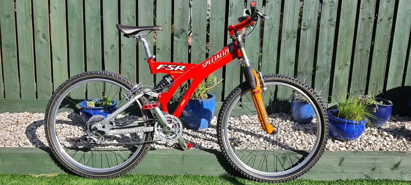

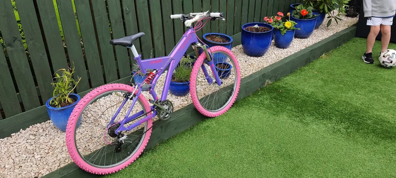

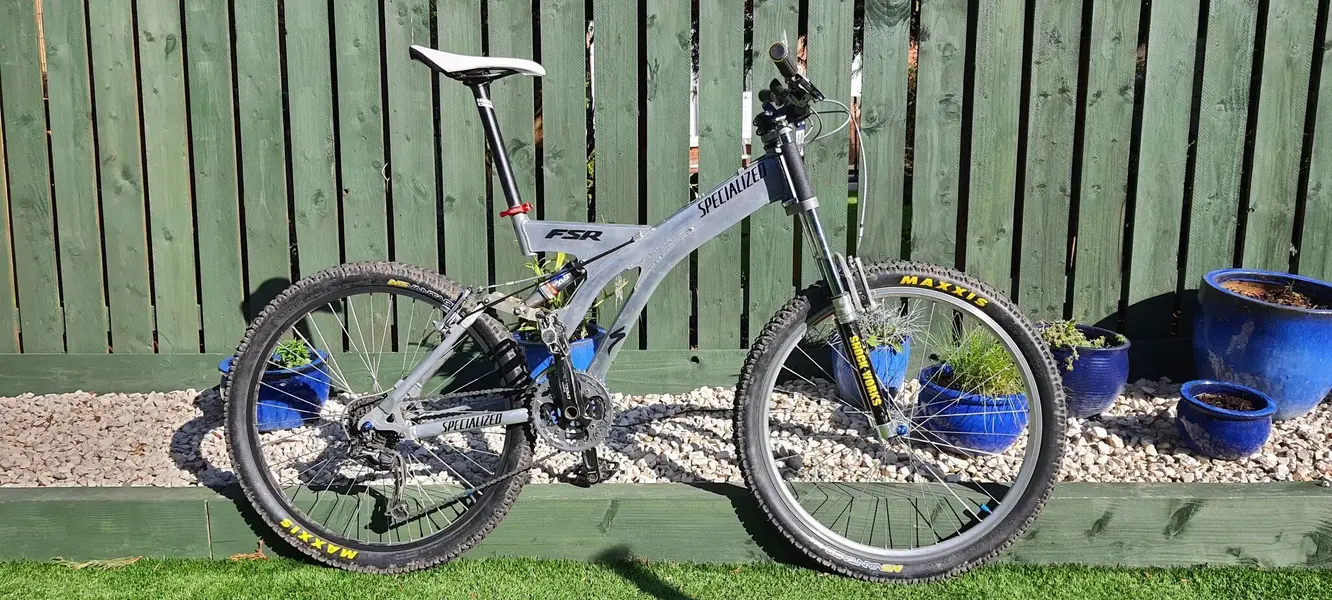

I've got three FSRs. Two with Fox Vanilla and one Rock Shox Deluxe
Yep, I might have to bite the bullet and get a Fox Float like most people do, it’s just frustrating as I tested the Rock Shox Deluxe and it still works fine.
I got a set of bushings for the Fox Vanilla rear shock from Offset Bushings, and while they needed a 1/2mm sanding off the end, they have made a massive difference to the quality of the shock movement.
I've also managed to find a Fox Float air shock to try to see what difference that makes. My 4 FSRs are (nearly) all on the paths and doing well.
