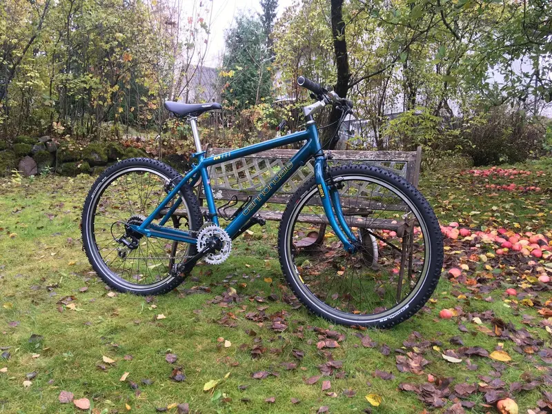

I don't have much to say, so just going to show my '92 M2000 in 20" size. No Force40 (one of the previous owners removed it), and no Pepperoni fork (it was bought by previous owner without it, but some suspension fork instead; that was taken off for his vintage suspension forks collection and crmo Alpinestars fitted), rest is mostly stock spec. As for road use… Not a fan of doing it with mountain bikes, but this one will do with some slick tires. It's not that heavy (although I don't have scales at the moment, but going by feel — it's decent weight), it's stiff and it is cool looking. PXL_20220501_145529186.jpg

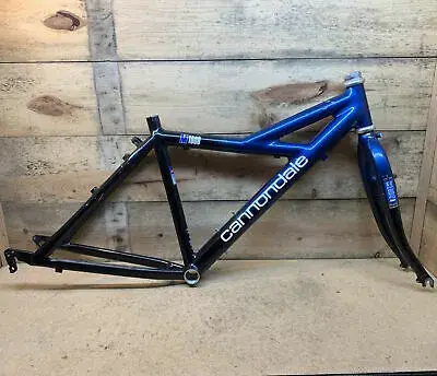

Somebody needs to inform me. What the deal with these C'dale frames? I LOVE the weird extra triangle look. I s it exclusive to smaller sizes? I seem to find two versions of the same model, one like this M1000, but was it also available with the boring straight top bar?
There are Killer V bikes and M series xs-size (14”) bikes with the same extra triangle structure, to give better standover clearance and add strength. The main difference is the down tube diameter (Killer V 2,5”, M-xs 2”). Larger M-series frames are with normal double triangle structure. In the photo an M500 xs.
