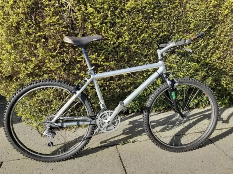

Can anyone help me to identify this model and year?
Clearly, it’s Cannondale and because the rear dropouts and the U breaks, a pre-1990 model. But what I don’t understand is this pepperoni, as far as I know they were 1” 1/8 and 1/4 and pre-90 frame were coming only 1”...
Unfortunately when I was about to close the deal a friend of a buyer bought it before. What a shame because it looked like a special bike.
I’m very curious about your answer.
Cheers

Actually the first Pepperonis from 1990 & 1991 were with 1" steel steerer. It was changed to 1 1/4" aluminum steerers from 1992 to 1994 and then changed to 1 1/8" for 1995 before moving to P-Bone forks in 1996.
That fork is from 1991 SE2000.
Pepperoni apeared in 1990 on the SM 2000 and SM Omega. In 1991, you could find it on Omega, SM 2000, 1000 and 800 (Best of the East) The rear suspension models SE omega, SE 2000 and 1000 got Pepperoni and the first version of Force40 with a pulley ( the system was developped because it was imposdible to mount a cable hanger with the shocker).
1992, pepperoni was 1”1/4 but the first model with aluminum steerer were replaced by classic steel. Un titanium steerer was developped for the mountain tandem. Force 40 is still a pulley system.
1990 omega, 1991 1MB and 1991 SM1000, my three ‘dale with first 1” Pepperon.
On my 1991, the Pepperoni got thd Force40 Pulley
