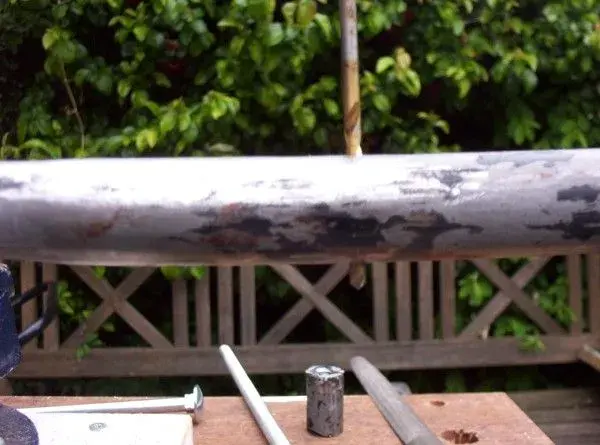

Thanks for all the replies. Had a go this morning and took a few pics. As will become clear, I am no metal worker. If you could have seen me leaping around the garden trying to get a MIG spark out of my shoe you would know that. Welding is a lot harder than you think! It is made from an old steel handlebar, some threaded rod (M10), washers and a bit of oak.
Picture 001 shows an M10 nut about to be welded into the end of a small length of handle bar. This has been rounded with a file to sit on the other piece of bar. A nut was welded (badly) into each end of the small section.
