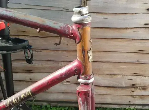

I found out that the answer is 'Yes!' :shock: Just bought a 1962 Viking Conquest - it's a complete, dismantled bike. My question was quick and vague because I was rushing as the bike had been reduced and I was sure it'd sell.
My current road bike is a Spa Cycles Audux ti, which i really like, but i'd like to incorporate some local cycle network routes on some rides and a wider tyre will help I think (the Spa takes max 28mm).
Anyway, we'll see how this pans out. :lol:

Ah I see I am a bit late adding a note of caution :facepalm:
I would have gone mid 70's because top racing frames were mostly running sprint (Tubular) rims by then, which you can transplant 700c wheels into, there is a great likelyhood that the frame you have bought would have been running 27x1and1/4 wheels which are slightly larger, wheels are getting harder to get hold of and you are more limited to the tyres you can buy for them too. As I am finding out at the moment :facepalm:
The fella I've bought it off said the wheels but either size? (I did say my knowledge is limited :-/ )

Well you are in good company :wink: :D If you have the original wheels it shouldn't be too bad just the tyre choice will be limited, looking forward to seeing more of the parts and frame.
Just had a quick Google of the parts with it - seems a bit of a mish-mash - seems like original stem & bars, a campag chainset, 80s Sachs gears, and weinmann brakes. Not sure about em the wheels. I only paid £60 for it - I'm hoping it'll look good with excessively battered original paint, but we'll see ounce I pick up.
