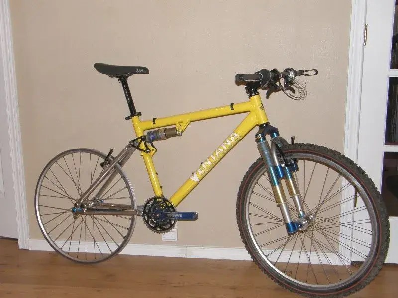

Here is my revisit to the MPFS I had with the PDS.
Just hung parts mostly, not really built, yet.
Specialized Ti BB, Raceface Forged (square taper of course)
Mavic 217/TiDyed Ti Spokes/ Carbon Nuke-proof hubs.
(Mine were 217/Ti/96XTR cause the carbons were $300 more!
my first PDS was Ti then I had a green one, I had Arch Supremes
but have not been able to land a set of those again so brakes are SD1.
That is my original saddle! The speedplay Frogs and Sidis are still here
too, but I have a Thompson Post on here and left the old raceface XY
off for now as it was added in the late 90's and this one looks just like
the control tech I had on it in the first place.
Ti bar, Stubbs bar ends, kooka racha copies (my rachas were lighter
than these but flexier) and a Dean stem for now.
Getting closer!
