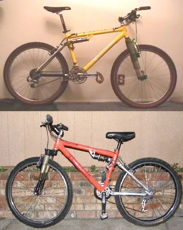

Here are a couple of pics from days gone by.
The yellow frame is the one traded from Sherwood Gibson of Ventana
to Steve Wilson for a stack of halson forks back in 1995. My buddy still
rides it. (I unsuccessfully try to buy it back at least once a year :( )
The orange MPFS is one I built for my wife 1.5 years ago (where one of my spare Inversions went I now remember!!).

Awesome Justin!
Those PDS clear boots look sweet! Would they fit the Inversions? I like the way the bootless Inversions look right now on the Blizzard, it be a shame to cover it all up with black! :lol:
