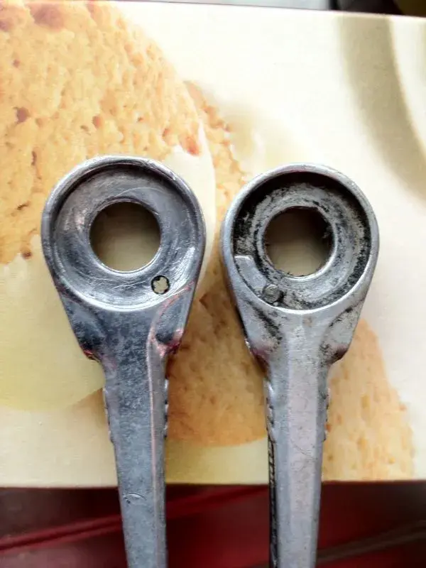

If I remember rightly, on my Shimano 600 Arabesque shifters the stops (which are designed to stop the levers rotating 360 degrees) are built into the levers themselves rather than a physical stop as in most other designs. In fact when I converted my levers from band-on to braze-on I had to mill out the built in stops to allow correct fitting on braze-ons....
My shimano 600 shifters are of newer generation but I believe instalation is the same.
The thing is, there is no other way of instaling these shifters but the way I did it. Nothing broke during disassembly nor during assembly, now as time passes by I could swear this is the way they are supposed to work...
do you mean the shifters can go further down than the above?.........they should stop parallel to the frame as above.
Shaun
so right now I positioned the silver "thing" that comes between shifter and frame so that stopper on it is pointing top, and in picture you can se position of shifters when pushing them towards front wheel (smallest cog and smallest chainring)
Looks like you've got it right now. The silver concave washer needs to go on the right way round, otherwise the lever has nothing to stop against.
