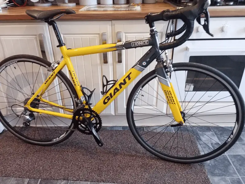

The seatpost on my giant retro mod keeps slipping :sad:
It has a factory fitted shim and no matter how tight i do the clamp up it slips , i did grease the post when i installed the new one that i made sure was the correct size as the original was single bolt that i can never get level .The seat can be nudged sideways too easily enough.
Take the grease off? carbon paste ? replace the seatpost clamp ? ( the last would be a shame as its the original once branded one )

Got a photo of the seat clamp/post/shim in position?

Since this original post I have changed the seat post and clamp, the original frame clamp is for a 30.6 post with the frame shimmed for a 27.2 post
Original seat post clamp I'm guessing as it's once branded ,the threads do look worn
