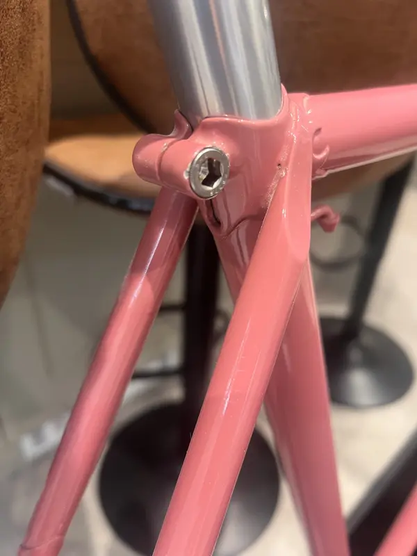

Seatpost binder bolt with threads in the frame

I have cable tied the Allen key for the seat bolt to the frame, it's an odd non-metric size and don't want to lose it...... Perhaps it's a 3/16 th :)
Shaun,
The integral seat bolt arrangement on your Thame Cronometro looks, to these old eyes, very much like my Claud Butler (other than shot in stays). Interesting to know if that zip tied Allen key is actually 7/32 and bolt a 5/16"/22tpi BSF as mine? Perhaps your Woodrup is similar? If so that would go a long way to saying, although unusual in today's world, this seat bolt would have been common back in the day.
Doug

Fleeting garage visit to feed "Fluffy", pulled the seat bolts from the Chronometro and the Woodrup (aka Kevin Sayles Jackson) and they have bolts the same as Doug's. Knurled recessed land, identical small chamfer etc. Both late 60's to early 70's.
I've got a few more later frames that l'll check ...3 x Aende, Holdsworth Classic, Rourke, Andy Thompson, Raleigh... however I think the bolts are smaller in diameter and take a smaller Allen key?
