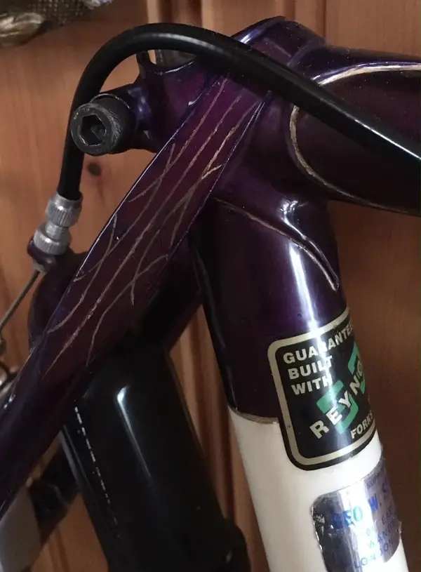

Thanks all. The 1/4 inch (not sure if fine or coarse) bolt I have does feel like it wants to go, but I’ve ordered a UNC and a UNF for comparison. I think it’s going to have to be tapped...
Even re-tapping depends on being pretty sure what tpi you have in there to start with. If there is a tpi discrepancy between the tap and the existing thread you just end up with a big ragged hole..

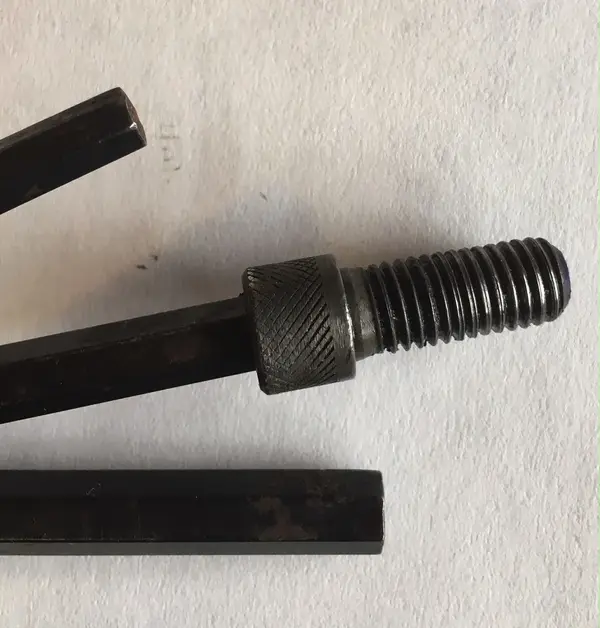

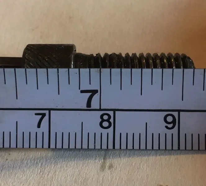

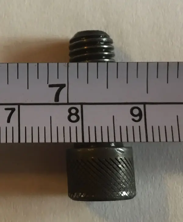

This peaked my curiosity. I have a c1968 Claud Butler "Super Torino" that was made to measure and it also has an odd size bolt in integral seat post binder. Lucky at time that it was still in frame when I received from seller in London. I just removed with a 7/32" Allen key and it appears to be a 5/16", 22tpi BSF. (I'm no bolt aficionado.)
https://en.wikipedia.org/wiki/British_Standard_Fine
Also found this site that seems to have the same bolt, even serrations on head although stainless not black. This is same length as mine - 3/4":
https://britishfasteners.com/index.php/ ... -6250.html
Don't have my calipers with me but... Thoughts? Could this be the same as yours?
Doug

Good that you posted, CBguy, otherwise I would still be wrongly thinking that 5/16" BSF is 26tpi, as 1/4" BSF is. BSC thread seems to keep to 26tpi across sizes: http://stevenott.com/ceithreads.htm
BSF of course does not.
I have edited my last post accordingly.
Your bolt housing is not counterbored to take the bolt head as mine is. Could it be that your style (exposed bolt head) are usually 5/16", and my style (recessed bolt head) are usually 1/4"?
I don't think your allen key can be 7/16". Maybe 7/32"?

Well my mistake - Allen key my bolt takes is indeed 7/32. I'll edit.
Also my 5/16, 22tpi, 3/4" long BSF bolt is recessed. I just didn't screw all the way in as I have seat post out. See pic.
