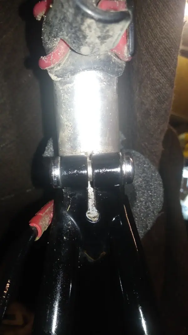

This is on my Bob Jackson Audax, that's a 27.2 Kalloy Uno seatpost, no wobbling and seems to fit nicely, had problems with the original clamp bolt.. needed quite a bit of tightening, LBS had to fit a new bolt because the original wasn't tightening up very well, this one has the little keyed bit that goes in the slot. Seems fine now.
Whilst on the subject you should have seen the diameter of the post originally fitted to my Raleigh Yukon when I found it, it was two sizes too small and they'd overtightened the clamp to the point the seat tube had split beneath the slot. I had to drill out a hole beneath where the crack had propagated and extend the slot down to that. Fitted the correct diameter post and can report no further issues.
Poor bike.

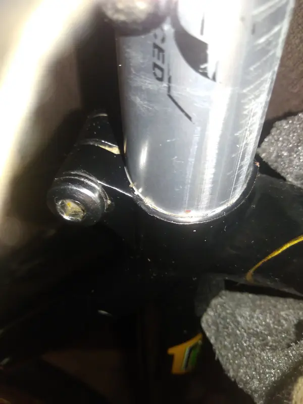

That's an interesting option, thanks.
I have measured the posts tried so far and the 27.4 is a true 27.4, the alloy 27.2 varied between 27.1 and 2, the 27.2 carbon post was 27.2/3.
Basically I think this means I need a seat tube size that was never made/sold.
My vernier only have 1 decimal place so can't tell the exact size.

I think you missed the point that even if you know exactly the correct size that the Seat tube is it doesn’t guarantee that the seatposts are true to size. I’ve had 3 x 27.2 Thomson’s and they all slightly different.
Anyway - a Lightning is 27.4 if has no shim and 27.2 if it has a shim. Finding a true 27.4 is the issue.

1. I currently own a un-shimmed Lightning. Which is fitted with the standard 27.4 post.
2. Last month I owned a shimmed Lightning which had a 27.2 post.
3. The standard cheap 27.4 post measures exactly 27.4.
4. I purchased a brand new Thomson 27.4 but it measured slightly over so wouldn’t fit.

Based on the trial post I have, it slots in fine initially and starts to bind further down the seat tube, suggesting the tube is not a constant diameter.
