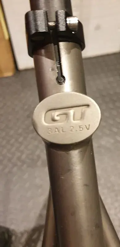

In the meantime I found a nice carbon post that might make the build. It seems to fit ok, slight wobble when the clamp isn't tightened but seems to fit ok once it is clamped. A few pics below of the slit in the seat tube pre and post clamp tightening.
Does this look ok?

Hmmm....that still seems to be pinching the top of the tube together a bit more than I would normally expect. What diameter is marked on the carbon one?

It takes a 27.4
Thats the size the frame requires. There isn’t any question about that.
some posts don’t measure exactly 27.4 hence why my Thomson didn’t fit. The frame size shouldn’t be your issue it’s finding a post that’s a true 27.4

Agreed.Have had the odd seatpost that didn’t seem a great fit but that 0.2 makes a big difference.Think the coke can shim May have been mentioned?Worth a dabble.Few coats of lacquer on the post worked well for me on a recent carbon build,now a nice,snug fit.Bit of grip paste for added security.Don’t know if lacquer would make enough difference here.
Other option is having either a shim or an ally post machined to fit 27.4.Wouldn’t want to take any metal from a weight weenie post but something with a bit of meat on the bones wouldn’t be so bad (common sense applied).If Coke Can does the job then that and a dab of grip paste or machining a shim to 27.4 would be my first choice.If there’s no original posts about.

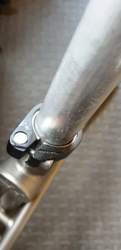

So the 27.4 trial post arrived today and it is very tight. Fits in the top fine but the further it goes the tighter it gets, I have to push pretty hard to get it down, and I was worried it would get stuck. It could nearly be ridden without the clamp being tightened, not had a post this tight in a frame.
Maybe this is why there is conflicting info on the correct size post online, as many claim it takes a 27.2 post, while others claim 27.4.
Heres a pic of the 27.4 post fitted.
The build requires a nice black post so its going to be a real pain to find one by the looks of it.
The carbon post i tried fitted better than another 27.2 post, I do have some others so maybe I'll find one that is really 27.3 ish?
Anyone found a post that does fit aside from the oe one, as I don't have that.
