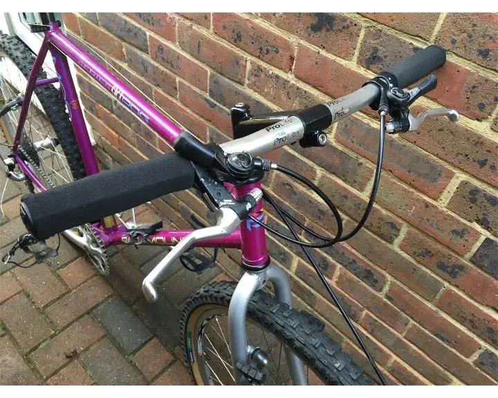

New cockpit layout. I ditched the bar ends as the reach is pretty far for me anyway. The levers look at different heights, but are the same - honest!
I've fitted a chain too, hopefully the rings will be OK.

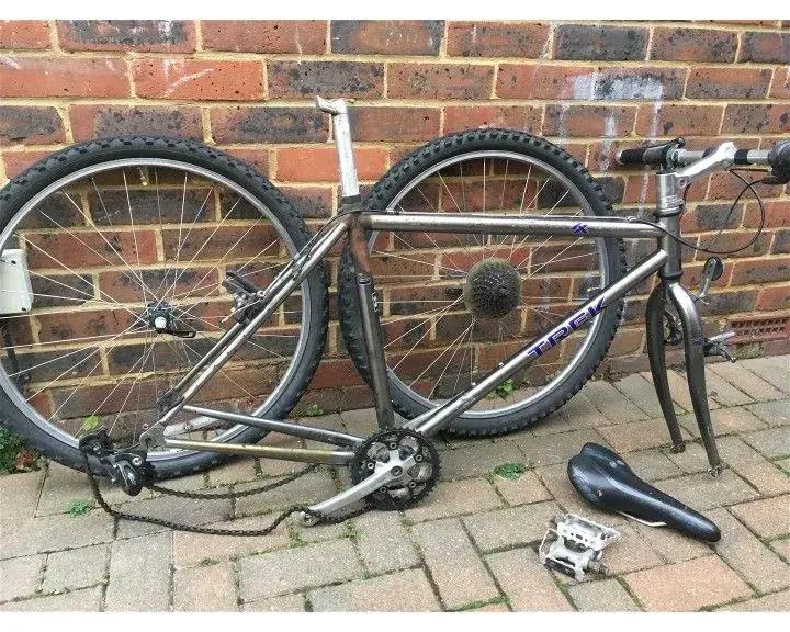

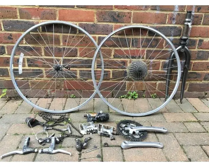

A visit to relatives in Dorset, via a detour to the tip :mrgreen: yielded this knackered old Trek. Although once a nice steed, the seat post was well and truly stuck - as evidenced by the scorch marks on the seat tube. However, the wheels were 'ok' a bit wobbly, with slightly notchy bearings and there were a few bits also that could be saved.

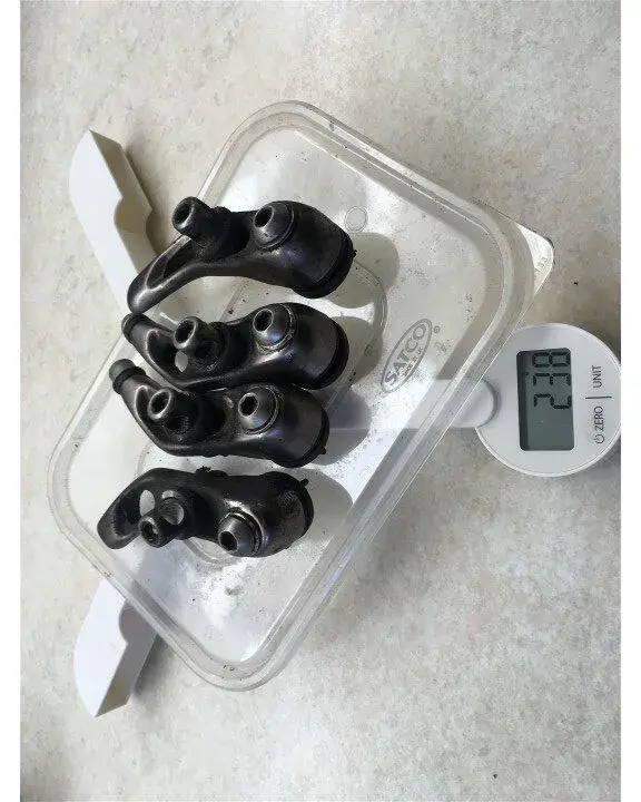

I compared the Suntour cantis I bought to the STX RC ones from the Trek.... My weight-weeny leaning over-rode my desire to keep it all Suntour, over 100 grams is a good weight saving.

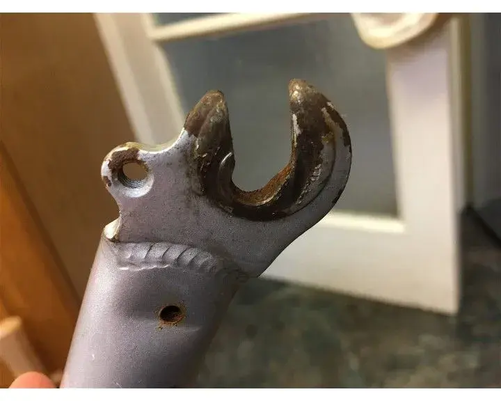

Then, I thought I'd fit my new wheels and cantis and attempt a first ride........ but the front wheel felt 'funny' when fitted.
:shock:
I need some new forks now!

I'm building a Trek exactly the same as that at the moment! Don't throw the frame, get some caustic soda on that post.
Jobs done:
Wheel bearings re-packed with grease
replaced cones in front wheel
Bought a set of forks
Replaced tyres - Fire XC Pro... from the tip!

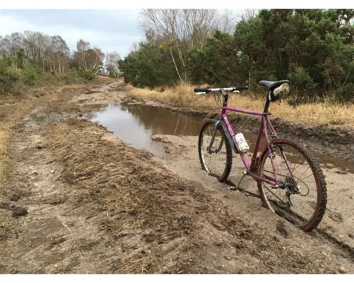

A nice set of Spinner forks arrived from CTK and with a bit of tinkering - voila, one posh winter hack. I rode it for 3 hours in nice dry, conditions :lol:
I bumped into Steve Behr at the local bike shop whilst on the maiden voyage - he complemented me on my fine retro steed. 8)
