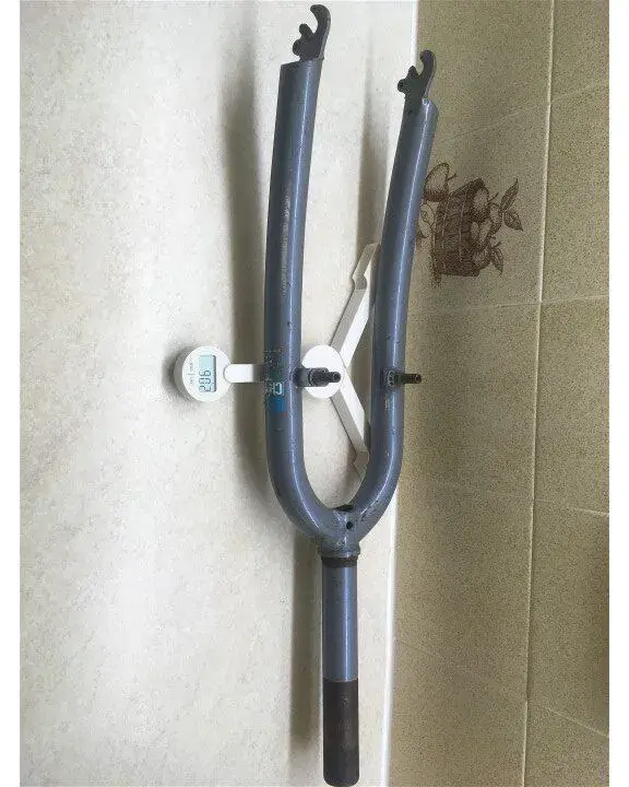

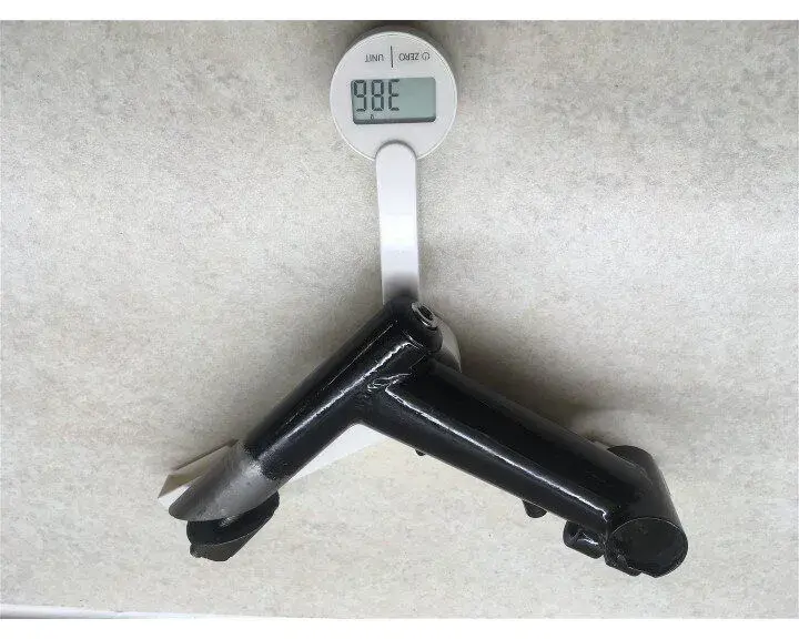

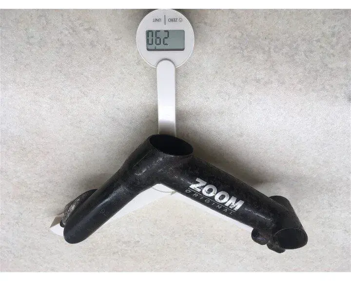

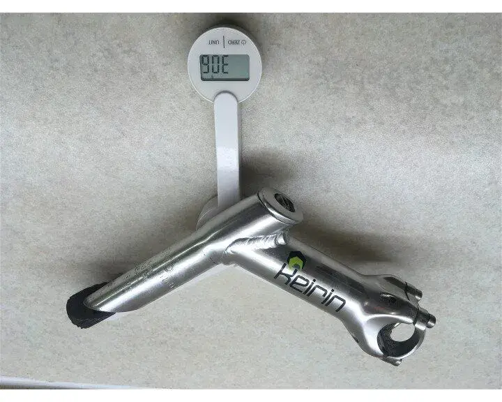

Sooo, the forks arrived from CTK. Nice, light Spinner jobs. I then weighed the stems I had. Since the steerer on the new forks was longer, I could fit a canti hanger, meaning I no longer needed one with cable routing. In the end, I re-fitted the Zoom one. The bike is too big for me, so the Keirin may go on at a later date.
Forks in, brakes set-up. I added a bit of inner tube around the headset to keep the cack out.
In the flesh, the blue forks are actually a good match to the blue of the decals.

A little digging revealed that the original stem: https://www.ebay.co.uk/itm/Vintage-Schw ... :rk:1:pf:0
was made by Kalloy…. so on the hunt for one now! Shipping a genuine (Paramount branded) one from the US, given the budget nature of this build isn't really practical.
