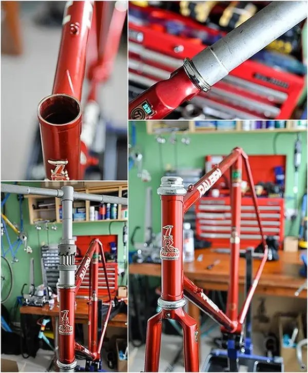

The Record headset was in perfect condition and as all the faces were well cut already, everything just went back together.

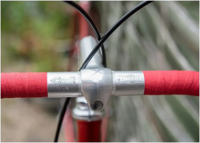

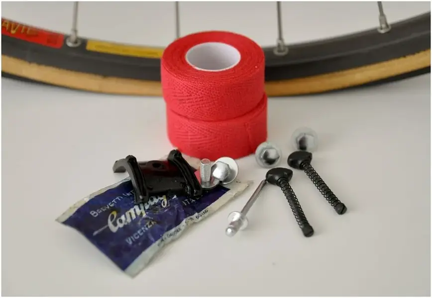

The bike came with tatty red bike ribbon on the bars but I've decided to go back to cloth bar tape - gonna give red cloth tape a go and see how it looks and feels. One of the drop out adjusters was bent and had to be snapped to remove it so I've replaced them to with Campagnolo replacements. Some of the TA fastenings were also past their best so a new set of them have been bought.

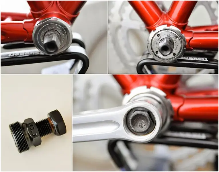

The Stronglight BB just needed new 1/4" loose balls and grease. Even with the best equipped Campagnolo toolkit, of all the tools required to fit this, only the fixed cup spanner is a regular size - the lock ring, adjustable cup, crank remover and crank bolts are all different. Just make sure you have a Stronglight crank puller if you have these cranks, 23.3 mm instead of the standard 22 mm. I have a really nice JA Stein puller that fits perfectly. The crank bolts were also 16 mm meaning that even the trusty Campagnolo spanner would not fit.

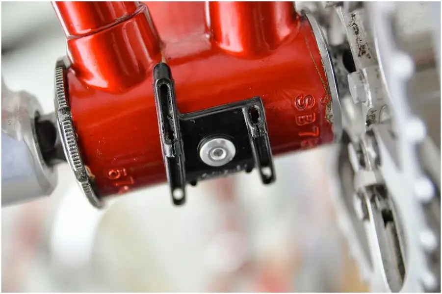

Next was a new pop rivet for the bottom bracket cable guide.

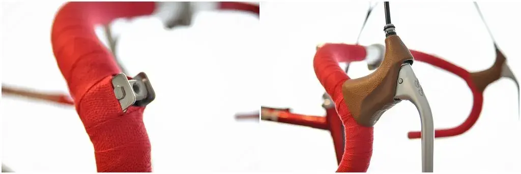

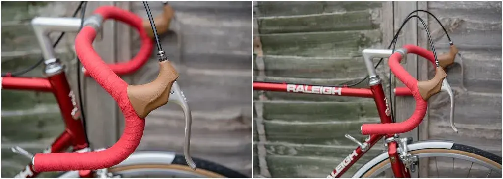

I got some Dia Compe replacement brake levers - tracking down good replacement hoods for the Weinmann levers that were in any kind of reasonable condition was impossible. I test fitted the levers to get the position correct and then removed the lever body, leaving the clamp in place on the handlebar. Fitting cloth tape can be a pain and I didn't want to leave any gaps in the tape around the lever hoods so taking the levers off the bars and taping around the clamp helps to make a better finish and look.

  • Raleigh SBDU Ilkeston Randonneur 531 1985 SB7660 Bar Tape and Levers Fitted.webp
  • Raleigh SBDU Ilkeston Randonneur 531 1985 SB7660 Campagnolo Headset Fitting.webp

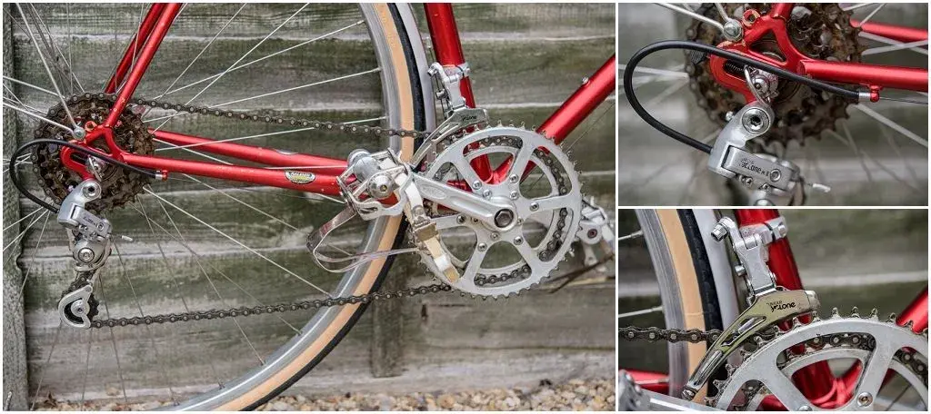

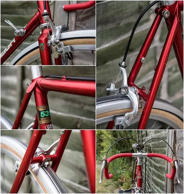

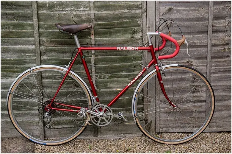

Finished this bike today. I didn't want to get this bike back to showroom condition, I didn't want to do a full clean and polish of everything. But just changing some bearings and cables, it rides beautifully. The Suntour gears work great.
New cloth bar tape.
New Dia-Compe brake levers and black outer cables (I don't like either red or white cables - so it had to be black)
All other parts cleaned up really well.

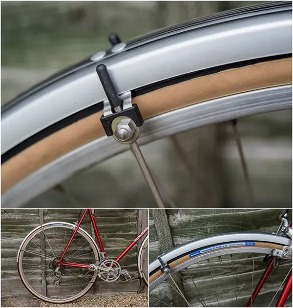

New SKS mudguards with stainless fittings fit close to the 28 mm tyres but still allows for 500 mm drop brake calipers.
