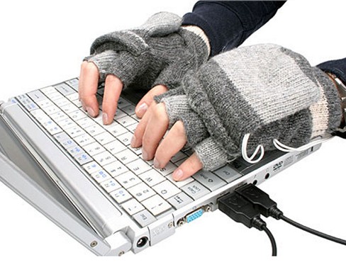

I just came across these ridiculous things:
They are gloves with a heating element that gets its power from the USB port of a computer. Did make me think of how nice it would be to have heated gloves for winter riding though. Trouble is, my bike doesn't have a USB port. And even if it did, the cables would be kind of annoying. So is it possible to run these on batteries? And what kind of batteries? I know nothing about volts and amperes or even which is relevant to get it working.
I would tansfer the heating elements from these to normal winter cycling gloves in case you thought I'd show myself in a public place sporting these bum gloves/mittens :lol:
