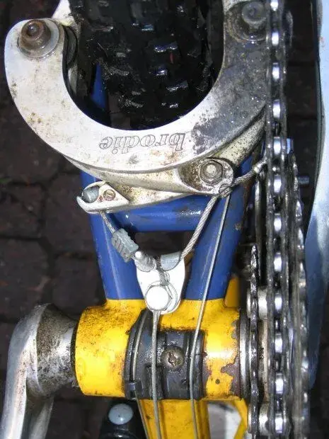

Here are some shots of my 88 Avalanche. The seat stay/seat tube junction is identical. Looks like the seat stay/chain stay junction is the same, too. However, mine has a cheesy plastic cable guide under the bottom bracket, where yours are brazed on.
A bit of history...I had to send the bike back to the factory in 1991, as the seat tube cracked on the back at a point about 5-10 cm below the seat tube/seat stay junction. They replaced the tube and repainted it. I was given the option of colour choice, I went for the originals.
When I had my consult with Dekerf for my new frame, I took in my Avalanche as a reference point. When he saw it, he said he remembered those frames because he'd fixed that problem on about a hundred of them, and was Rocky's resident expert for that repair. I wonder if a previous owner had that same thing done and maybe got the extra touches done - that's pure conjecture on my part. Otherwise, I'm thinking you have a Blizzard, too.
My Avalanche's serial number is R8097, if that is of any assistance.

Yeah, good thing about that BB cable guide. I noticed that when I looked at a German Blizzard from '89 I believe, the other day. Unfortunatly this detail hasn't been usefull so far to determine the exact model.
The Blizzard and Avalanche from '88 and '89 had slight differences between each other, perhaps this is just one of ehm
