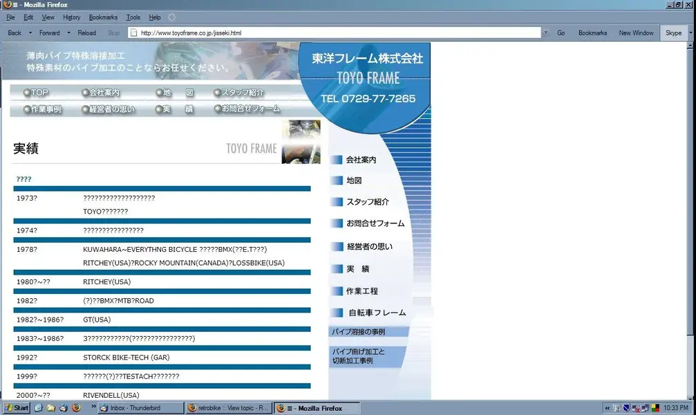

For fun, I checked the Toyo site, they have made bikes for a few favourites on this site. I wish I could read Japanese.
Oh well, I like looking at pics of bikes being constructed. Boy, I really wish I had those skillz.
Hmm... your screenshot gave me an idea... Im going to contact Toyo.. they for sure have records on these frames. With the framenumber they should be able to tell me 'what' it should be... Why didnt I think about that before? :P
