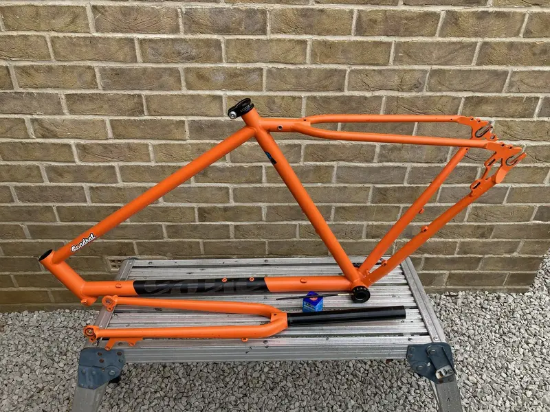

Finally…after the winter preoccupation with Alps…the frame came down from hanging forlorn in the roof of the workshop, the wheels were retrieved and the various components of choice brought together….
First off…the frame. Many chips and dings. Careful sanding of bad pits and bare-but-rusty metal. Application of the right RAL code paint - thanks Cy for the code number. Delicate and fine painting with a high quality model-making brush, using three layers to build depth. Looked horrible. But the moment the paint dried, it matched exactly. Phew. This was a two hour job, done in good but diffuse sunlight to see precisely what needed to be done, and the May heat caused the right sort of paint curing - fast but not too fast.

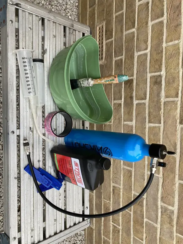

Next - setting the rims up tubeless. The paraphernalia looks like a drug den tool kit. But….after application of TESA tape of the right width (this is where Stans source their tape, I am told, from Switzerland) the tyres went on and tubes went in…pumped up to 50 PSI. The tape had been stretched tight on application, six inches of overlap at the valve hole, then a pinprick with a pick to make a hole for the valve. Assembled with tube, left overnight, this really causes the tape to adhere well. Next morning, the usual strict routine of tube out, valve smeared with Stans in, then bead locked with a blast of air from an inflation tank and a brush of tyre mounting fluid. Valve core out, Stans in, valve back in, wobble and shake, then to 40PSI and hope the next morning all will be airtight. And lo and behold…..everything fine.

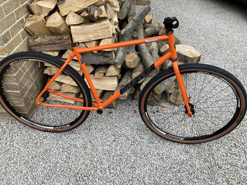

Black Hope BB prep’d with lots of antiseize - a used BB but nice and tight and good and smooth. As usual with a COTIC, the BB threads are slightly tight - cleaned them really well and brushed with a brass brush, but still tighter than optimum. Oh well, no reamer in the workshop, so in it goes, slightly wearing the alloy cups. But hey ho, not too bad. All good. 68 shell so two spacers on the drive side and one on the non-drive side.
Headset….I want Hope….give me Hope.
I have Accor. Top cup and bearing King. Top cup and bearing Cane Creek. I search for matching lowers on line. Nothing. Don’t want to use the Accor. I want Hope.
I resort to buying a newish gunmental Hope on eBay. OK, not perfect colour but it will do.
I then find (DUH!) that I have a perfect Black Hope in a box on the top shelf….bah…..in it goes.
Of course…if I had read this thread I would have known I bought a black Hope bottom to match my random top, and it was in that box….oh the error of leaving a big gap between starting and continuing with the build….
And it goes in simply. Carefully align bottom cup and press H A R D to get it to catch - gently tap with soft hammer to get 2-3mm of insertion and the alignment spot on…same at top…fret that I should have put bottom in first, fully, and then done top. Oh well….proceed slowly and carefully. Install headset press and slowly wind up, watching that both cups are aligned in the tube properly and are keeping their alignment as they go in. All good, got away with it…
And then a stem….simple, I have reserved a Burgtec and cap and bolt and that goes on simply. Looking good. All black and orange all BRITISH….
