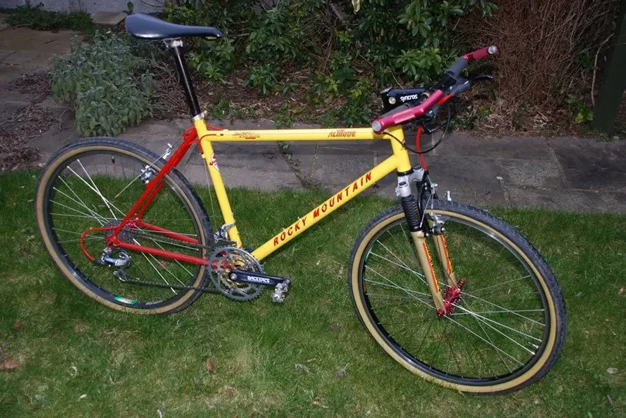

I'm going to use the wheels I had built for the Blizzard which is now Retired so they will be..
Red Ringle superbubba up front and red Ringle 8 speed Shimano hyper glide on the rear laced with double butted stainless to Araya RM40 black rims.
Well that's the plan if the front hub fits the Rockshox dropouts ( they don't fit in Pace RC35's ) with red Ringle holey squewers ...of course
Nah not Black Beauty
The 1992 Blizzard has a nasty dent in the top tube from a crash last year it will need a new top tube when funds allow so for the moment it is retired.
To get large contact spacers to fit on Mag forks you need to file the inner tabs of the rockshox if it has them and you may need to file the top edge of the area where it starts to taper to full width its not a lot but the shape was annoying to file. I've done that so my Hope Mono's fit on mine. Work really well at binding the end down though.

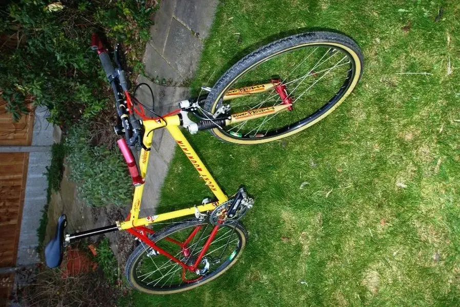

A couple of pics in bad light been out for a spin and she rides very well
forks work and the hub fits a treat so all good
