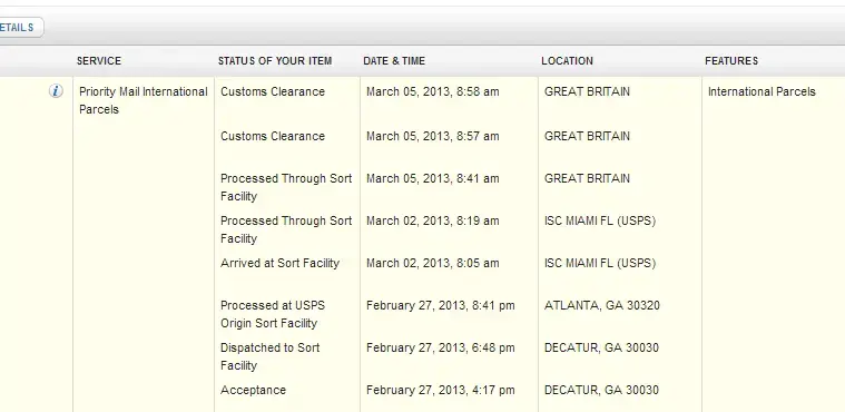

And she's made it onto UK shores... hopefully not much longer now. :D

Haha cheers Pete ,not arrived yet but not far away
I expect she is in Nottingham now so will be here soon....my precious :shock:

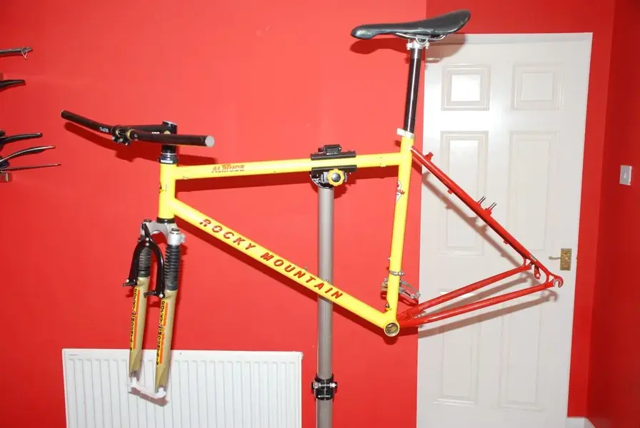

Ok me hearties

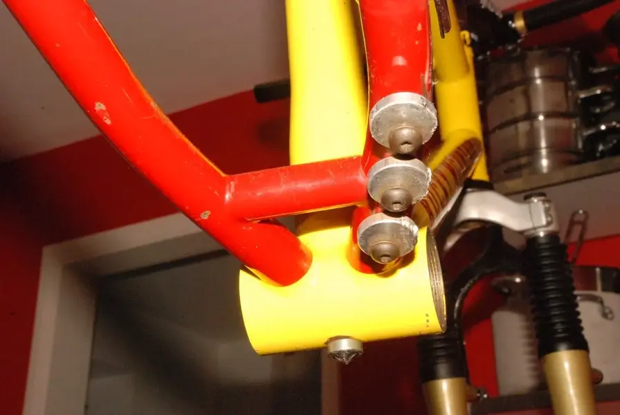

I picked the Frame and a few bits up from the Percel Force depot in Nottingham on Friday and have only just had the time to start tinkering so a few pics of progress so far and a close up of the Chainsuck device.
The Chainsuck device is beautifully simple you just have concentrically drilled Aluminium washers which you can adjust to meet the chainrings. I will get some new ones made up as these are a bit used.
I have also finally got a system for fitting bars into Syncros stems ...you just put the two bolts in from the inside and use a shim in the slot so that as you wind the bolts forward it opens up the slot ...simples I cant believe I never did that before .
