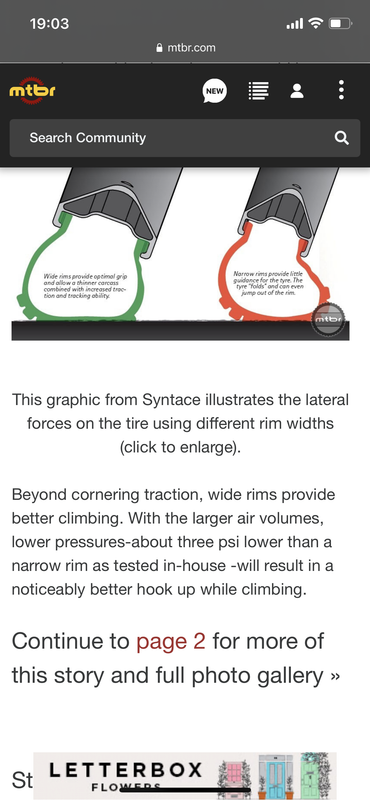

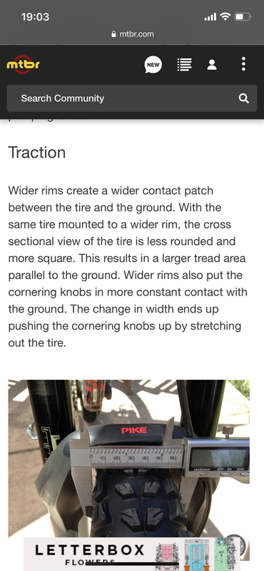

But surely a wider rim would give a squarer shape to a tyre which would lead to more contact area? Assuming same pressures and tyres used?
I was running 27mm rims and 30mm rims on two bikes. Same tyres and same pressures and the wider rim had a squarer profile tyre in contact with the ground.

Right - wide rim gives a short contact patch, narrow rim is longer. The area will be the same, but the short contact patch also gives less tyre deformation (the bulge at the bottom).

I’ve read this 10 times and I don’t get it.
OK, a narrow tyre has a contact patch like 0 whereas a wide one is like O (looking from on top)
The wider rim puts the beads of the tyre further apart, reducing the thinner waist of the tyre at the top - so it's more of a shallow U rather than a tall one (for the same tyre). This in turn reduces the twisting squirm of the tyre. The tyre will twist in a corner, not only sideways but front to back (called shear). Again, a short contact patch reduces this twist / shear. On cars, that's why we use low-profile tyres.
