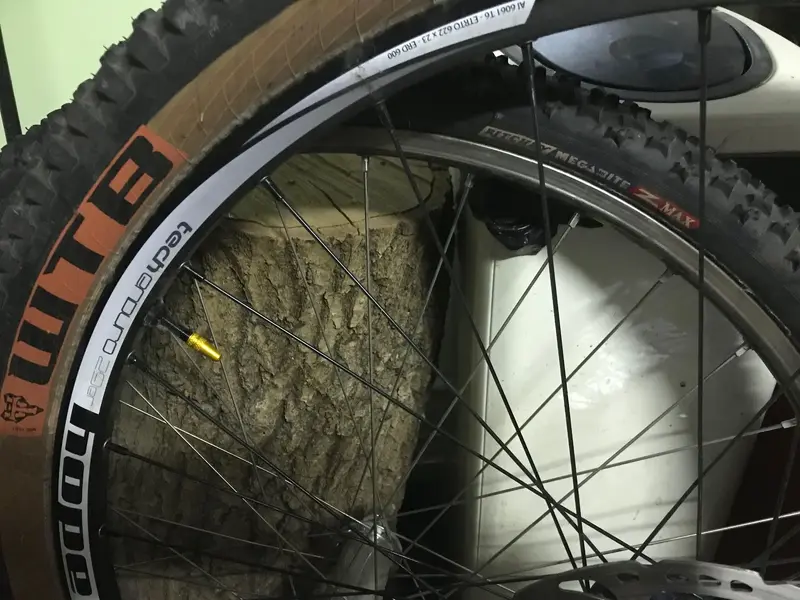

2 different sized tyres (a 1.7 x 26" and a 2.4 x 29"). Both at 30psi. I've measured the contact patch with a consistent weight (me) applied. Who'd like to make a prediction?

the test subjects;

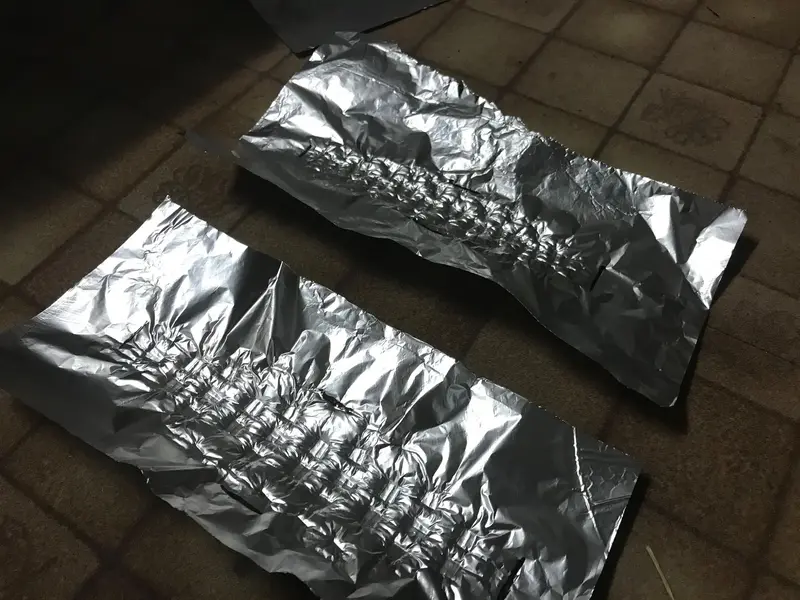

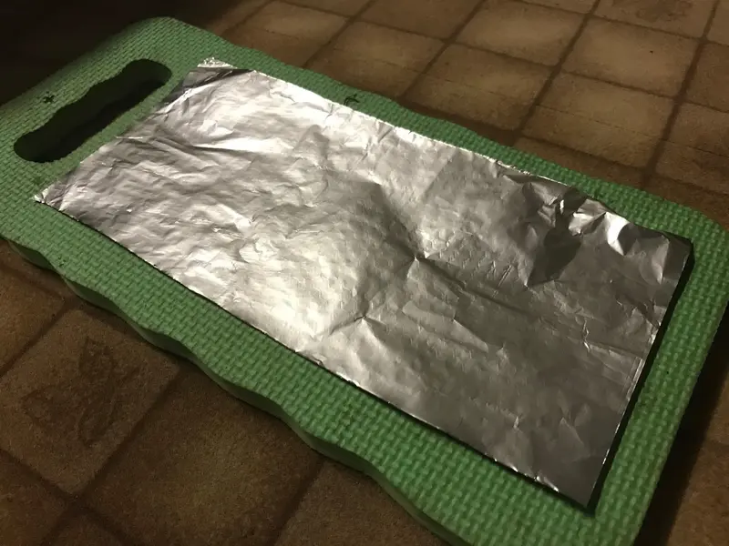

some high density foam, with a layer of tin foil. I put a front wheel onto it and rested all my weight onto it.

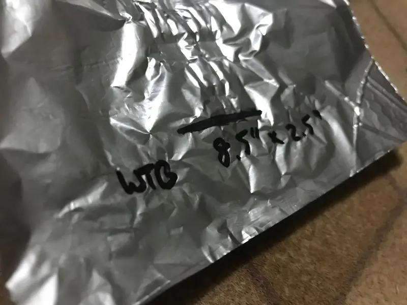

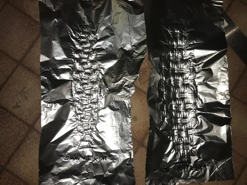

At this point I marked the furthest points of the tread depression with sharpie, and measured the maximum length, and width. I tried not to flatten the sheets at all.
Apologies for the angles of the photos, I know it will throw off the perspective, but foil is hard to photograph :oops: :oops:
the WTB was a full inch longer, and 0.75" wider.
I flattened out the foil, and the Zmax gained 1/8", the WTB1/4" width.
they were both at 30psi.

So lots take this to the limits of tyres width and rim
If we take a 3inch tyre and fit it to a 18mm wide rim it will have the shape of a ballon. Really narrow at the rim , with a rounded profile.
Same tyre on a 35mm rim will be squared off.
I can’t see how at the same pressure they will have the same contact patch. First one will be narrow as the tyre is having to curve to fit the rim.
If you Google this exact thing there are lots of articles written regarding it and they all say the same.
https://www.mtbr.com/threads/tech-why-w ... e.1170103/
https://m.pinkbike.com/news/rim-widths- ... -bike.html
The irony is I know Hamster is *technically* correct, when using a perfect scientific model. A 'perfect' tyre on a 'perfect' substrate will act in exactly the way he describes.
FABULOUS, what a brilliant experiment - the foil and foam is an absolutely inspired way to get the print.
It does raise an interesting question about the effects of such big tyre knobs on the contact patch, as the tyre will hang between them.
