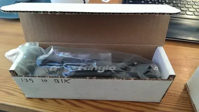

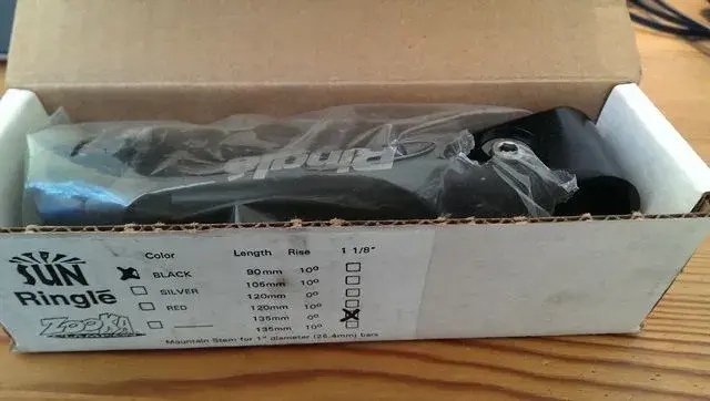

Could anyone help me out on a small mystery. I have some Ringlé parts that is new in box, where it says Sun Ringle on the box but where the parts are Ringlé parts... This both goes for some sun-of-bubba and suber-duper-bubba hubs, but also the Zooka stem. The stems are clearly very late as they have the lazer engraved logo. Some of the stems are boxed in Sun-Ringle boxes (some in neutral boxes). How late will these be? Help needed?

These are "genuine" Ringlé Components products. There was of course a transition between the business being bought and transferring to the Sun-Ringlé products. Probably around late 1997 or so. The address labels changed from New Jersey to Indiana with the move.
Sun moved the manufacturing offshore so the CNC machined parts gave way to forged parts and more mass-manufacturing techniques (cue lamenting discussion appropriate to all our favourite brands; the names got bought up, the brand dilutes, less special and cheaper, but also not so appealing)
