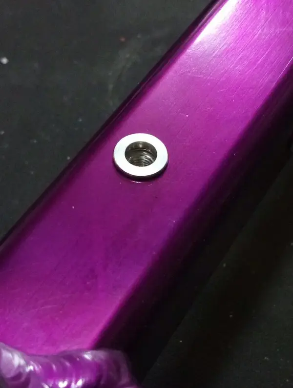

Sourced the correct rivnuts to match originals, so M5 in silver aluminium (not the usual plated steel, which would tend to cause galvanic corrosion of the aluminium frame), with a large flat flange. Here on the right:
Rivnut fitted. This one is for the front mech roller:

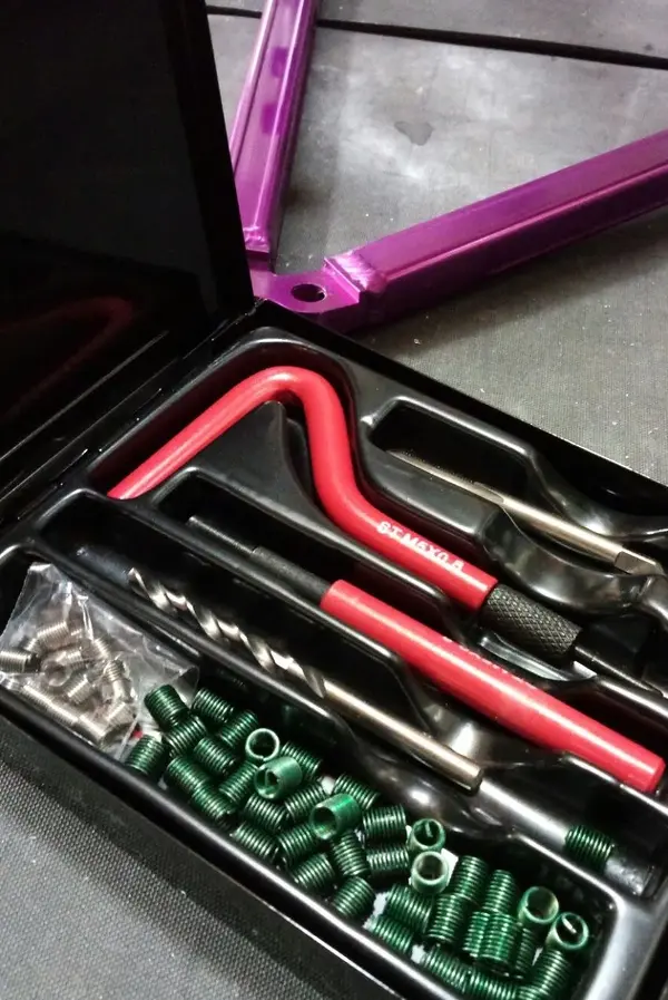

On to the helicoils.
These are stainless steel shaped wire that fits into an oversized tapped thread. These are often used for repairs of damaged threads, but are also very useful where a durable thread needs to be made in a relatively soft, weak material such as aluminium. The green colour of some here is an anti-galling coating over stainless steel.
4x M5 for the Magura mounts, and 1x M6 for the seat clamp. Here is one in place, you can see the larger holding thread in the other hole:

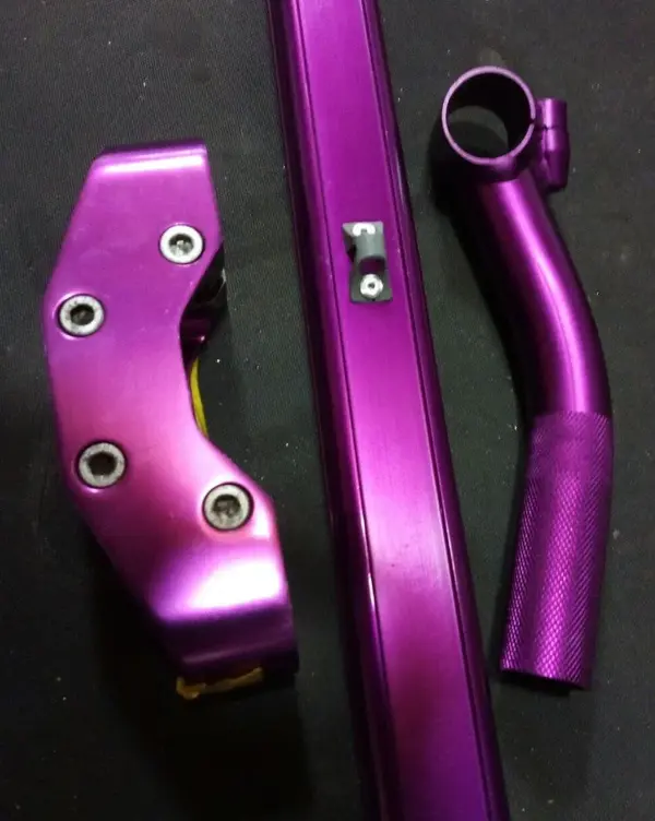

Little plastic hose guide rivetted back onto the top tube (3mm aluminium pop rivets).

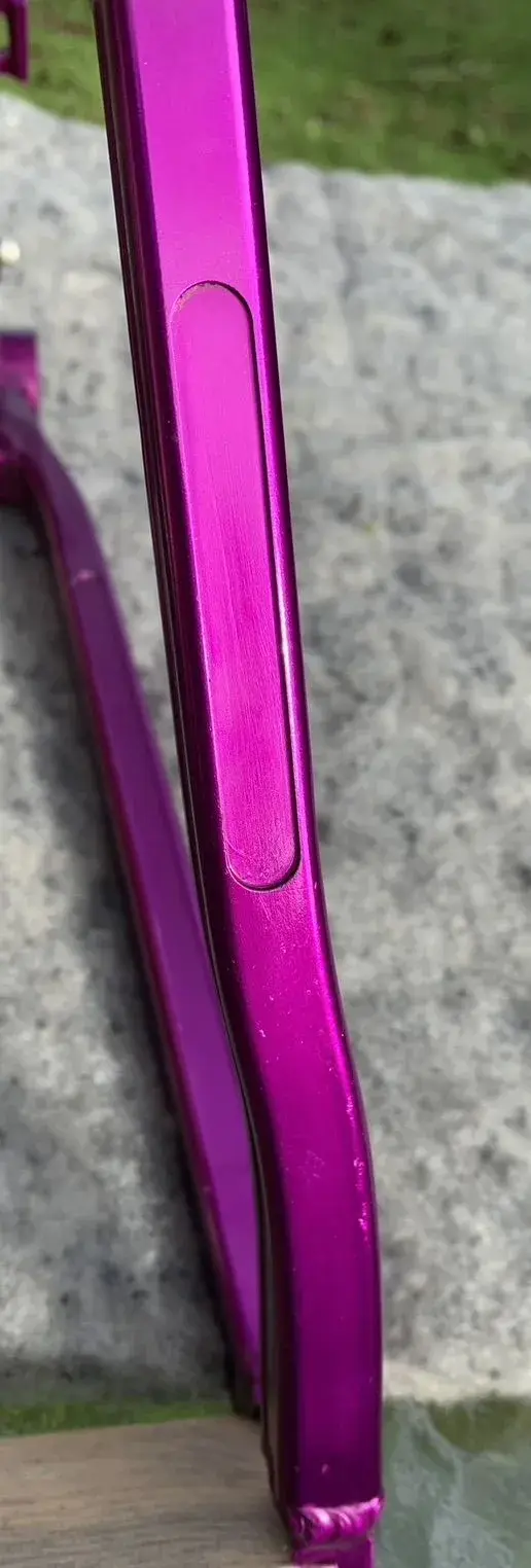

Decent colour match between the original fork crown, the re-anodised purple frame and the changed colour bar ends. Probably 3 different alloys, and from 2 different manufacturers.

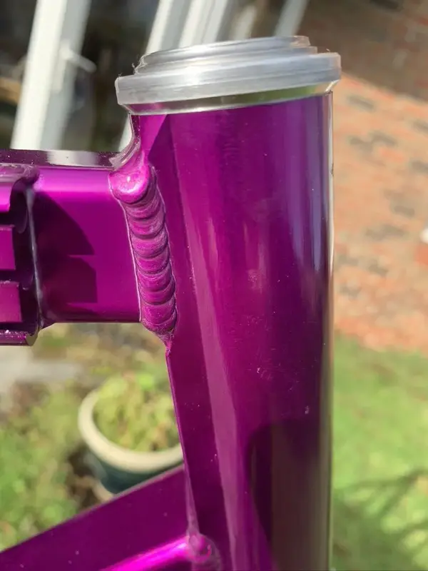

Head tube bore and faces reamed of anodising, chamfered, then headset cups fitted.

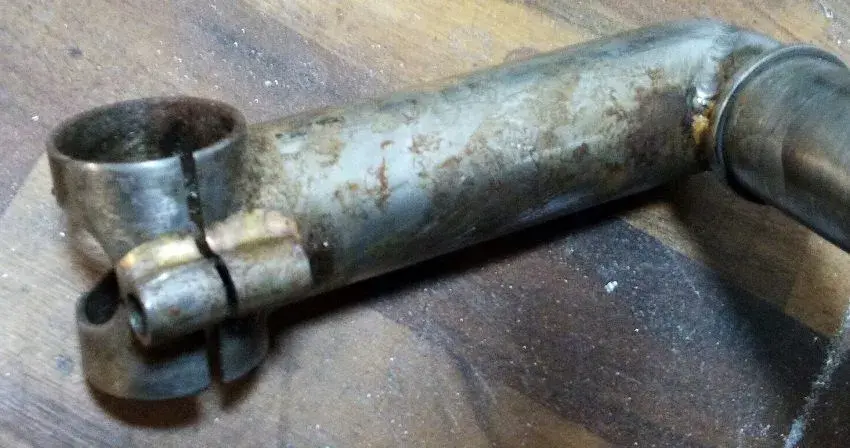

And a small side note on the stem/steerer combo.
The one supplied had been spray can painted a rough grey/silver colour, but Dave wants a chrome finish like Richard's.
So strip the paint to have a look underneath. No sign of previous chrome or nickel coats, but plenty of rust worms:
Light sand and polish all over:
Then off to the seaside to the chrome platers.
Still waiting on this to return...their work is good (mostly classic motorbike parts etc), but the communications can be terrible..they're always a weird bunch to deal with, chrome platers...I put it down to breathing those fumes all day. :D

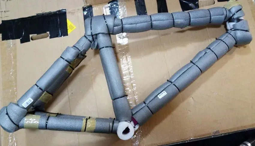

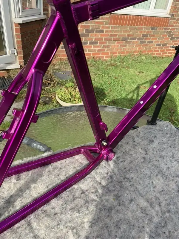

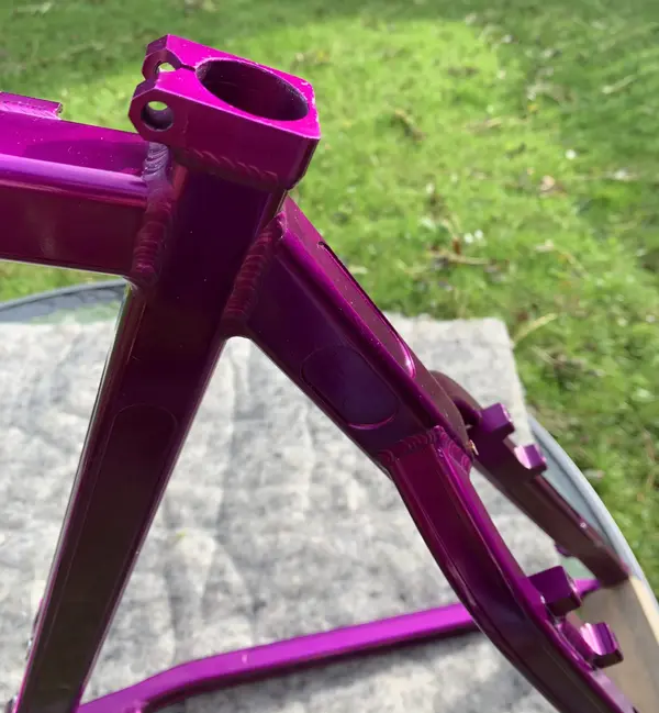

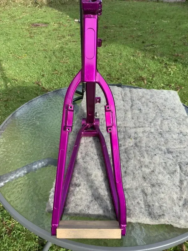

Time to show what the boxes contained in more detail. It's fair to say I am totally blown away with the work Dan Chambers (danson67) and then subsequently Acorn Plating have undertaken. I only took on the restoration following two pieces of advice from Dan.. The first was just to make sure it was repairable and secondly to secure his expertise and craftsmanship to undertake the repairs (I personally wouldn't have taken it to anyone else).
a video and lots of pics, the video can be found here :
https://youtu.be/fn29KF8Bc_c
