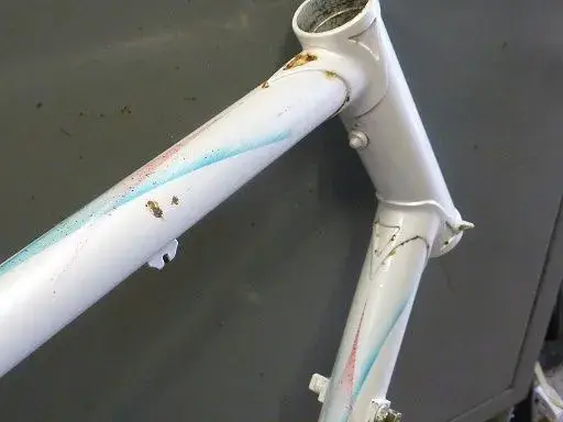

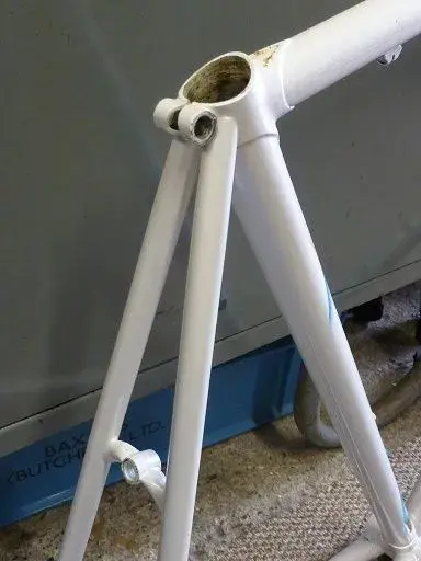

That's the nub of my issue, I'm not entirely sure :D . I'm leaning towards mid 90's upper-range Peugeot, due to build similarities, but there are no transfers (other than the 653 transfer) to confirm this. I'm trying to track down an example of their frame numbering at the moment to provide confirmation, but no joy so far.
No such luck Shaun, it's had a respray as you can see below.
It's got the under top tube cable guides, rear brake bridge, shot-in stays, two bottle cage mounts and rear dropouts that i'd associate with the Athena model, and the frame number begins with a Y, which I believe is common to pugs.
On the downside the lugs have cutouts, there are cable guides on the headtube and the fork crown is not one that I can find on any Peugeot catalogue scan. So I'm not really sure what it might be, any ideas?.
Matt

Had a quick look at some of my frames. The Peugeot 653 serial number begins with a Y and then a 0, indicating produced in 1990, corresponding with the catalogues. This link should take you to the relevant copies. http://cyclespeugeot.com/Catalogs.html
This was the 'garish' purple, Athena groupset, fantastic bike. The pump pip, chain pip, blow holes in the tubes, cable guides, brake bridge all look similar to yours, but the lugs on mine don't have any cutouts, in a spearpoint style, and the forks look different. The drop outs were chromed and 'Simplex' written on them. Afraid don't recall stripped down weight, but know that my 753 frames both weigh in the 1700 gm range (58 cm) and don't think 653 much heavier. They didn't use 653 tubing for very long. FWIW I do find the forks a little more forgiving than 753.
I also have two Peugeot 531 Pros, serial numbers begin with Y then 8, indicating 1988. Similar frame detail as described above, and they only made these for year or two.
Good luck.

That frame looks italian, especially the sloping fork crown and lack of chainstay bridge. It could be Dedacciai or Columbus tubing. Have you measured the tubes with a vernier?
