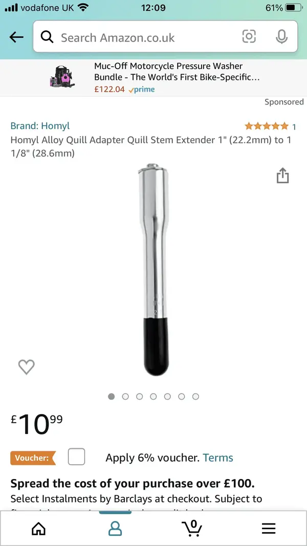

I think woz might be right it could be worth spending the money and get the fork modded....once and done... fit and forget...threaded or ahead..world's your oyster.
