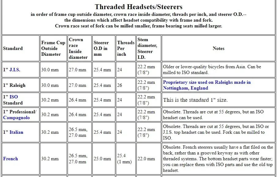

To be honest, quite unlucky of me to get the 27mm race fork.
So, any ideas why I shouldn't use the Tange race with a campy cup, as long as the fit is nice & snug, and the headset turns OK?
I think that cups and races are matched by bearing diameter...it means that one side of the balls contact is exactly opposite the other..IE through the balls center line...i think you'll get a headset for a while but it could go nasty fairly quick.. but if you find the magic size bearing that might make an improvement!?
Right just pulled one of mine to bits...I have a fork from a 1937 la Fileuese that's a 27mm crown race.....through luck it would appear the one I've fitted has such a huge lead/chamfer on the bore size of the race just before the seat lands on the crown it snugs up...😄 That's a 26.4 race btw!
I think the tree your barking up is correct...make it fit...file it dano....the fork obv not the crown that won't work!.🙄 Keep trying it on ...it'll leave witness marks were it gets unhappy...too tight it'd crack....if it ends up baggy.....cough ..epoxy...cough....which is what I've done on another and that has a some mileage now and appears fine!
Now as for uptop.....not on the la Fileuese because bizarrely the original is very happy but on my other Frenchy fancy...standard British 1" thread goes on....🤨 It's not right sure but it's not so loose it's come loose !

Been brainstorming this one for a while now and rummaging through the workshop trying different options.
Bottom cup is simples. Plenty of solutions. For the record, if anyone is facing this issue in the future (to repeat, running a 27.0 fork race into 30.2 frame cups which can happen with some French, Italian and JIS forks):
1) Buy Tange Passage/Levin JIS headset (to borrow the 27.0 race) + tange passage ISO (for the ISO cup). Both run off 4mm bearings, so races are interchangeable. With cheapo Passages the cost is £25 - pretty sure that's what I've paid for a used bottom cup on my summer bike (ok, ok, it has "hope" written on it). Both headsets are low stack, so should work in prehistoric frogbikes.
2) Any JIS bottom headset fitted into the frame with a beer can shim. Up to you to decide whether it's safe or not, I've never tried it. you'll be fitting cups designed for 30.0 frame into 30.2 frame; a beer can is supposed to be 0.11 - on paper they were made for each other.). Don't blame me if it goes tits up.
3) Potentially, any threadless EC30 ISO with a split ring (Both JIS and ISO seem to use the same 45 degree cartridge bearings and come with identical split rings regardless whether it's a 26.6 or a 27 race!). If your stack height allows (sealed headsets tend to be taller).
Neco H673 and H610 seem to be low-stack models.
3) Potentially, a combination of a threadless JIS race into a threadless ISO cup (Both JIS and ISO seem to use the same cartridge bearings). If your stack height allows (sealed headsets tend to be taller). Threadless JIS race can be taken from a £9 Chinese MQUZI threaded cartridge headset. You'll need an EC30 for the ISO cup though (good luck finding one!).
In my particular case, I have an old Campy mirage cup running 4.76 balls that seems to be very happy accepting the Tange race designed to run 4mm balls. Very strange. Even stranger, the Tange race for 4mm balls (supposedly a Campy rip-off) does not run in another campy headset designed to run 4mm balls (that one only works with a campy race).
I'm either going to run Tange + tange or tange+campy. Campy cup's destined for the bin anyway, I have nothing to lose apart from my teeth.

Right.
Found a low-stack threadless cartridge bearing EC 30 headset (Neco H673 and H610). Split ring race covers both 26.6 and 27.0.
Hopefully, a £25 solution to a million franc problem.

Right.

How are you going to stop a 1" JIS or ISO top cup with the wrong diameter and thread flopping about? They are too big.
The steerer is only 0.4 mm bigger than the EC30 split compression ring, so a couple wraps of gaffer tape, some epoxy, beer can shim and a squirt of WD40 will sort that out.
I will try to use double lockrings Sheldon-style to apply & lock the pre-load on the compression ring and the bearings. I am running on the assumption that French steerer is the same as modern M25x1. I'm no engineer, but it seems to be the case. Will try once the alloy nut arrives some time next week.
You are correct that my previous thought of using an ISO threaded cup for a threadless set-up is flawed. That set-up requires some sort of a compression ring too - the ones you get in threadless headsets. Unless you have a 1" kicking about, you might as well buy an EC30 headset.

Stop stop stop .....
Where are your getting at least the very top French locknut from in all of this pick-n-mix? :confused:
Oh dear...I'm gonna have to pull Nocim apart ....it's a longtime ago since I did it and I can't remember what was done....but that has a new headset top and bottom...matching...it does have the french filed flat thread washer and the top nut has been modded to remove the stop but that's it! Unless Nocim is iso 🤨 I doubt that!
