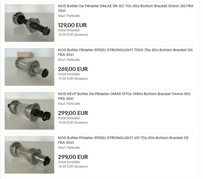

Was looking at Ebay.fr and Leboncoin for French headsets and bottom brackets - it is shocking, virtually nothing and the NOS prices give you vertigo. Oddly, in the USA there seems more choice 🙁
These are the only NOS FRA BBs in France.
I spent the afternoon doing a little pre-study about a 26" Monster Cross, measured some parts, and did some quick maths, looks like it would be doomed due to getting the brake pads about 13mm lower. Everything else seemed feasible. Going to keep my eyes open for some cheap 650 B wheels. Even wondering if the BB problem can be solved with a beer can shim!
Eyewatering prices.
Makes me want to cry as I fished out a Columbus-tubed Stella sx-76 frameset for a pal on ebay a wee while ago. In good condition with mint original campy bb and campy headset for £75 delivered :p
I know I'm about to lose a lot of forum credit, but I'm a sealed bearing guy. Was just going to shove one of these into the shell as deep as Franny can take it.
