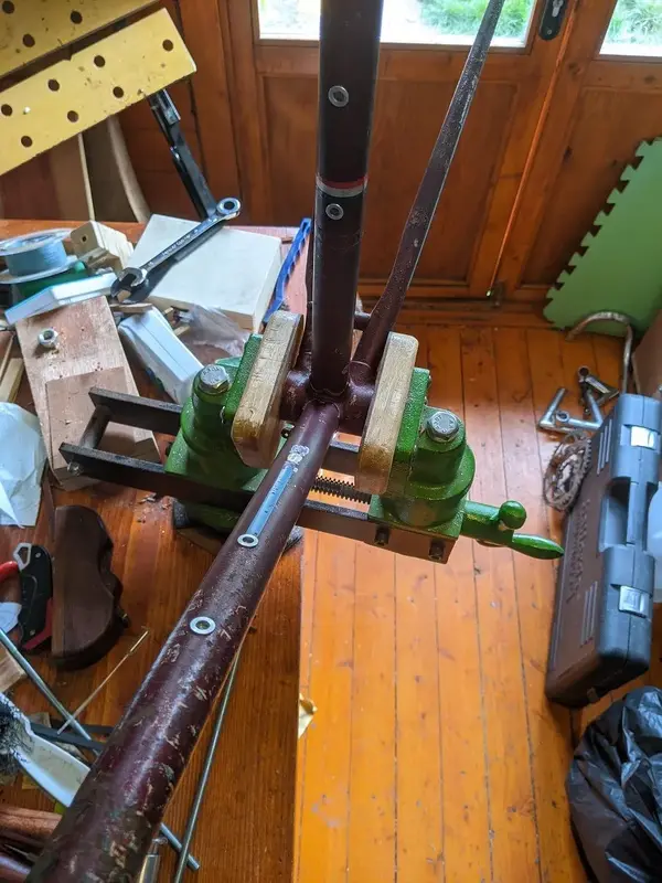

Bosses in place. As a bonus, they are almost centred on the tubes!
For a 7mm rivnut I've drilled 3mm holes, then enlarged to 6mm and then finished off with a 7mm reamer. The reamer leaves a nice round hole while the drill bits seem to leave a bit of a jagged edge.

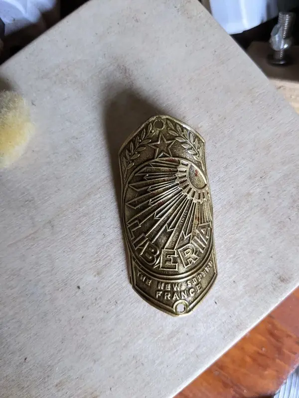

Also polished the badge with a dremel and coated it with several layers of shellac. Hopefully that will stop the oxidising process.
