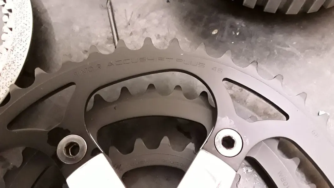

Here is a set of suntour rings i did a few months ago.
Blimey, those rings look great! I'll do a spot of research now thanks for gloss black on a stem....going to dally at the weekend with autosol on the rear of my SG rings...what's the worst that can happen?!
