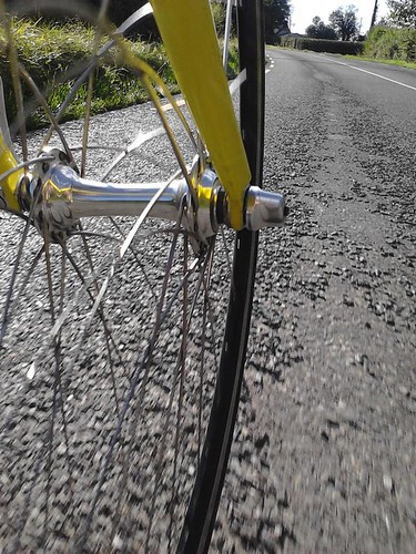

The bike loks great and i like the 'action' shot too!! I am obvioulsy jealous of the smooth road too.

The bike loks great and i like the 'action' shot too!! I am obviously jealous of the smooth road too.
Hi Richard,
Thank you for your comment.

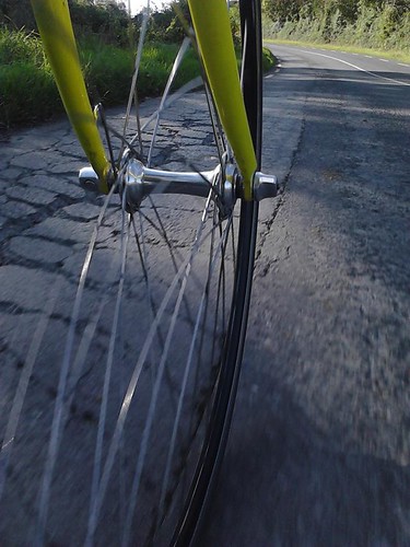

Believe me, the roads in my area are far from being smooth, and that picture just shows an exception (probably due to lower shutter speed, etc.). Here are some other photos taken during the ride that shows the truth :oops: :
Any time I go abroad with my bike, I am amazed how much better roads are elswhere.
