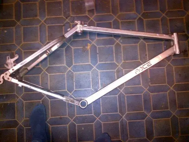

Ive just found a crack round the base of my rc200 seat tube, again at the weld with the bottom bracket.

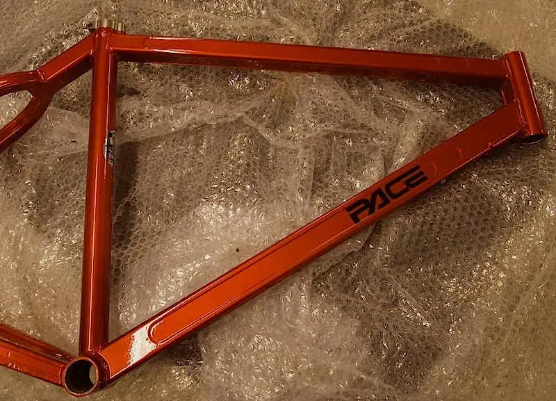

Final result...off to Papillon for dressing. It's more sparkly orange in the flesh.
Before:
After:
More pics here.

Yup, it is powdercoat. Good quality Austrian stuff:
Tiger Drylac 049/25002 Dormant Sparkle Copper with a gloss top coat. Colour Chart here.
There are plenty of lovely powdercoats out there.

Top job! :) ....love the colour too! :D
Super cool stuff 8)
