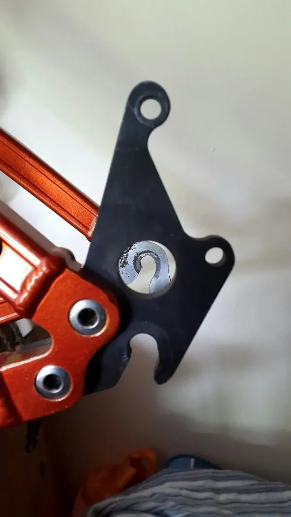

Just thought I would up date yes I have nearly sold the frame 3 times every time it comes to parting with the frame I just can't do it! So I am making progress and change to my original plan that I was going to do, sorting through a box of 80s/90s parts I found some drop outs for a pace well I found a few sets track, geared and disc. Don't no or remember where these came from but have enclosed photo ( any info on this or brake calabur would be good ) it has quite a large hole cut out why?
So it will be built up with a rear disc brake front v brake rear cassette and single 50t up front, just in the process of purchasing 2x carbon rims to be built up with hope hubs and I will put cross tyres on it as I commute via trails.
If anyone can shed some light on the disc mount that would be cool also re fixing after market brake and gear fixings for the frame.

Having trouble with photos let's hope this works disc brake mount on RC 200 F4
Any info would be good thanks
Papillon

That looks fine, Max, sticks up a bit, but standard ISO 2000 spec.
Does it match the RH one OK? They might be from different manufacturers, given the different finish. Pop a wheel in and see.
I have some black anodised rivet-on cable stops and guides for the brake and gear stuff if needed.
Just the front brake that needs sorting. Looking pretty hard to find canti mounts to fit the 28.6mm fork legs, so maybe one of these instead?:

Hi Dan took frame up to Vernon Barkers in Dromfield, he still does the odd bit but the frame builder put the frame in a stand got this little disc jig out lined it all up and said it was IS standard and fine, what are the front ones you show in the photo and what am I looking for?
As for fixings think I will be running hydrolic brakes so do you have some cable fixings for hose, think they have a plastic clip that goes on after to secure hose,
Looking at a company in Hong Kong that is called Light Bicyle they make some nice carbon wheel sets and rims, also looking at hope, sram and xtr brakes 11 speed rear cassette with a FSA or SRAM 50t single up front,
The brake and gear fixings should pop rivet on if I am right, are they flat back or a little curve?
Cheers Papillon
