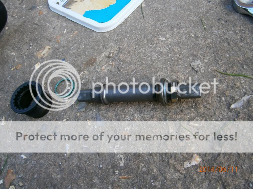

Hi can anyone give any suggestions for getting the fixed cup of a bottom bracket without the special tool.
The one which has 2 flat sides for a spanner :?
I managed to get a spanner on the nut and get it off :lol:
Never seen one of these before :?
Am I right in assuming I just need to stick in some new bearing and grease it up ?
How easy is it to remove rest of the bottom bracket ?
Is it pressed in ?
Get a big washer on the outside large enough to cover the whole cup, then a large shortish bolt that fits in the washer making sure the nut can fit inside the bb with a socket on it, then place the washer and the bolt on the outside of the cup and wind the nut on inside the bb with a socket and extension, holding the outer nut with a spanner, when the nut is tight enough to stop spinning carry on tightening with the socket and the cup should just wind out...................... I think I have that the right way round :oops: :facepalm:

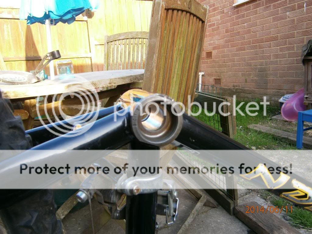

I have managed to get the outer part off, it looks like a pressed fit inner section :?
So I am going to slap in some new bearings, grease her up and wait until I can get a bike shop to remove it, I get impatient and wreck things :oops:
