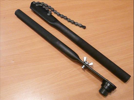

I had a similar problem with a Regina block that it needed the axle removed for the splined removal tool to be inserted then I found an easier method by holding the block with a chain whip and using a second chain whip to unscrew the smallest sprocket (similar to a cassette lock ring removal) that then allowed normal insertion of the removal tool.....voila, no more hassle!
Griff
This is a genuine Regina freewheel removal tool
Blimey that's a lot of metalwork to remove a freewheel......isn't that a remover and chainwhip to remove a casette lockring?
