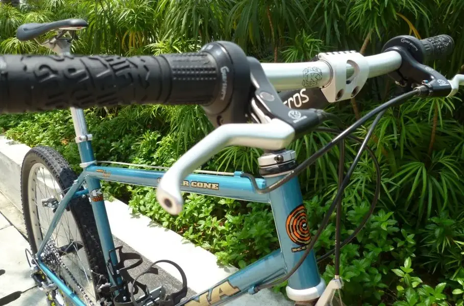

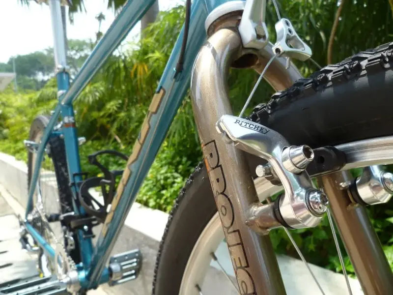

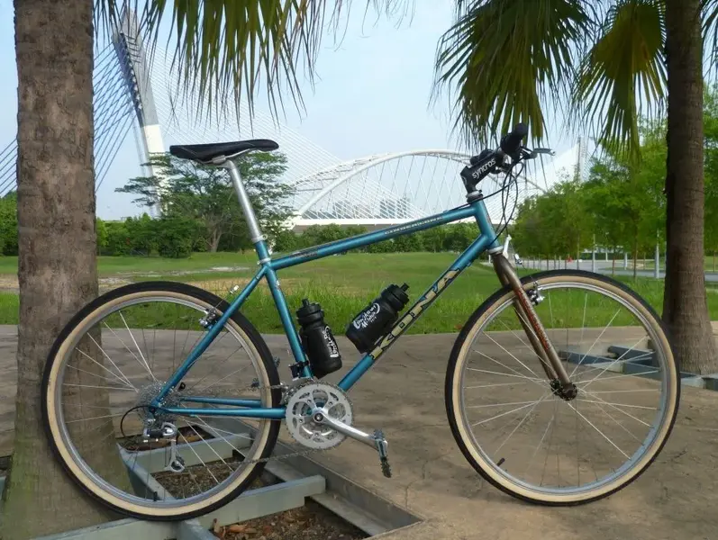

The bike is finished and rides great, nice and tight and pretty much silent drive train while riding. Here are a few finished pics with road tyres and saddle:

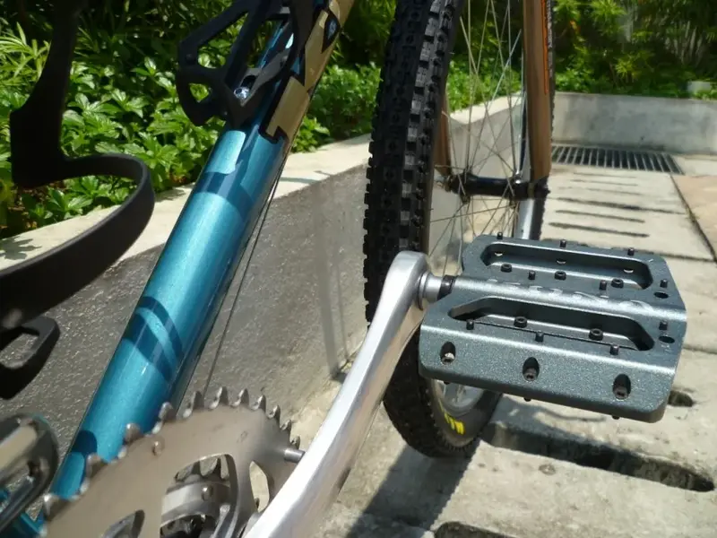

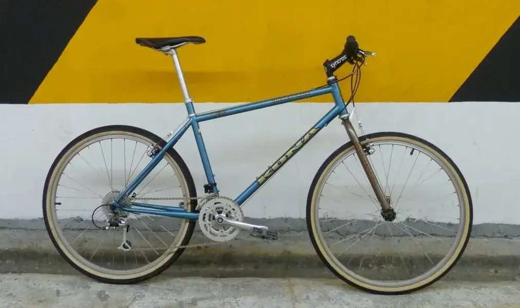

Re: Refreshing a tired '95 Cinder Cone - Updated 11Aug
Then today it got some fresh XC tyres and saddle, so all finished and ready for action :P
